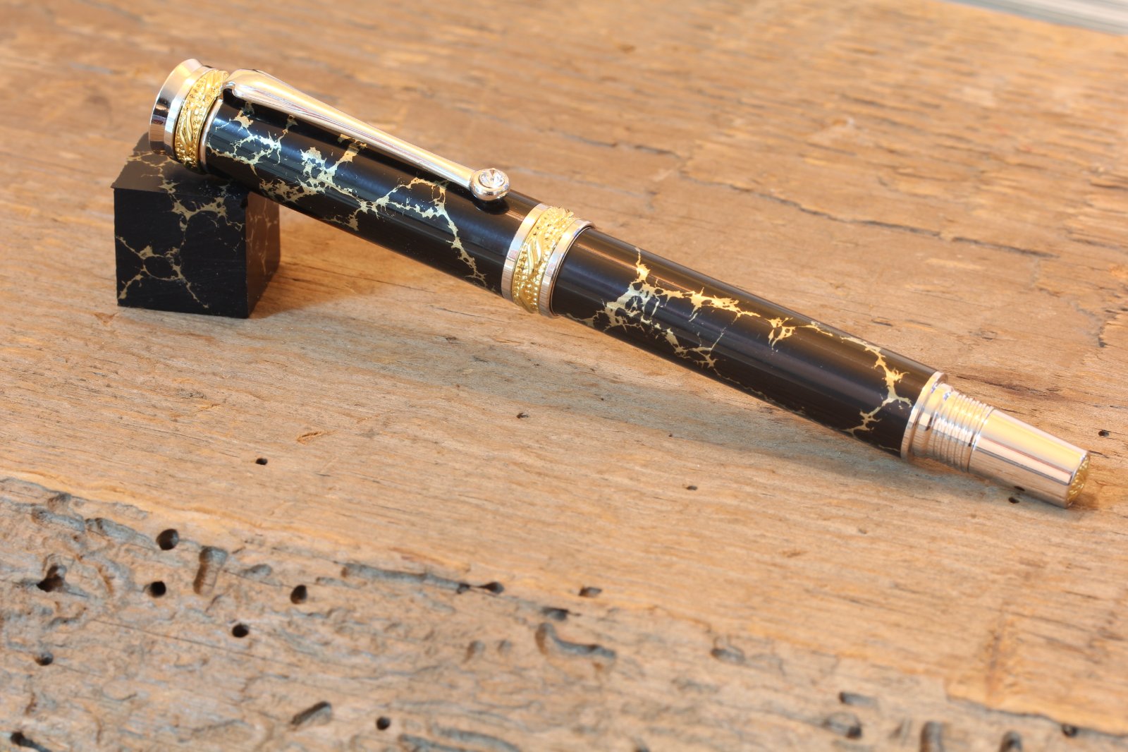

The gold veins are especially difficult, the material wants to break at the veins when drilling (see my video on popsicle stick reinforcement, if you want to improve your odds)
And the material is expensive, so failures are costly!!
