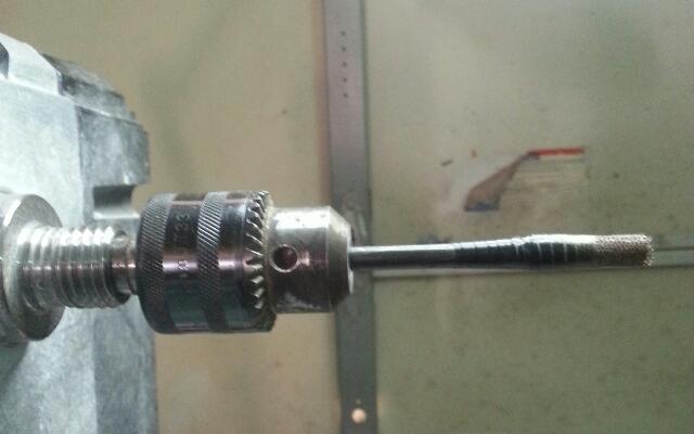

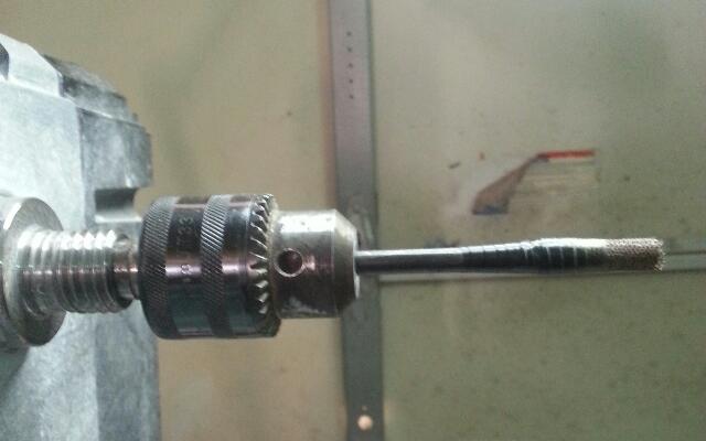

My Harbor Freight rotary tool was worth the $8, so I now use a transfer punch with Abranet taped to the end in a Jacobs chuck in the headstock to sand the inside of the brass tubes:
