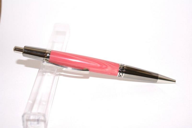

I picked up this blank from Woodcraft - pink coral tru-stone. They warned me of turning tru-stone several times, so I was up for the challenge.
Cutting on the band saw was very easy. Next drilling on the lathe - drilled just like acrylics as well as squaring up the blank.
Next onto the lathe....turned as easy as a bar of soap would turn. Shavings came off initially like soap shavings, then ribbons like acrylics. This was so soft ...needed a very light touch turning. Wet sanding created a great slurry very easily.
I have turned acrylics that were harder, as well as Ebony and deer antler.
So I question if this was really tru-stone?

There are different hardnesses of trustone, some rather soft. The ones I've turned did so like you described, well maybe not like soap, but I've had a harder time with some acrylics.
AK
Not always, but generally the lighter colors seem to be easier to turn. If you start getting into the dark blues, purples and black, you'll see a big difference. One purple one I did dull my fresh sharpened HSS skew in about 30 seconds and prompted me to get my first carbide cutter.
