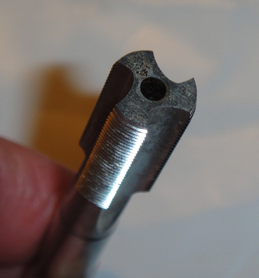

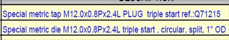

I got a similar quote for the 0.8 pitch, though they quoted me for a bottoming tap for some reason:
Our P/N 31178
M12.0 x 0.8P x 2.4L triple start Bottoming Tap,Standard Class 6H, 4 Flute
1 pc price = $152.90 each
2 pc price = $117.15 each
3 pc price = $87.89 each
6 pc price = $65.67 each
9 pc price = $53.68 each
12 pc price = $46.42 each
24 pc price = $41.36 each
Delivery: 3-4 workdays to manufacture

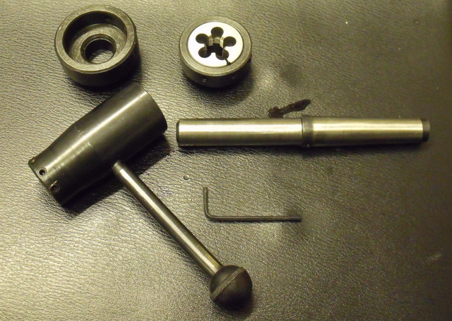

Alex, did your die holder come with only one diameter capability?
Here's a pic of mine which can take 4 different diameter dies.

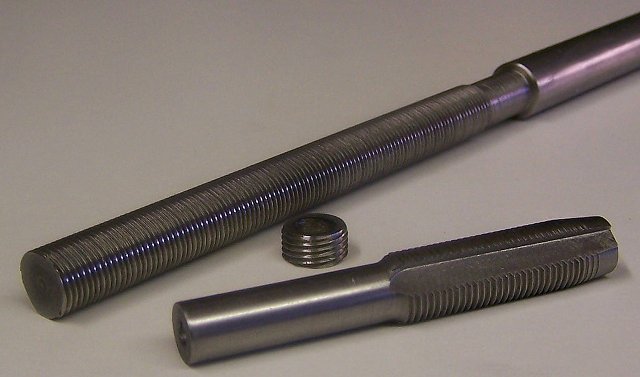

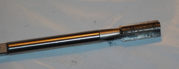

For those that go ahead and get these taps and dies please heed my advice and get a taper tap and a split die. :wink:
I also added a pic of my own 3 start tap that I made from stainless steel.
I simply threaded a rod on my lathe and formed the tap from a section of the threaded rod. The threaded rod 'was' going to be for couplers and the tap for matching threads in the cap. But I don't use them anymore:rolleyes:
okay Skippy, give.
If you aren't using your homemade stuff any longer, what are you using now, other than kits?
this is all I got, it holds 13/16" and 1" dies: one size per end.

Hi Guys, Mike at Silverpenparts.com tipped me off on the attempt to get an order together on the triple tap & die. If you can get enought (now or later), you can put me on the list!
Not that it matters, but what size (OD) would the die be (standard 1 1/2" round)?
Let me know if I need to contact anyone with my contact information separately.
Thanks...John

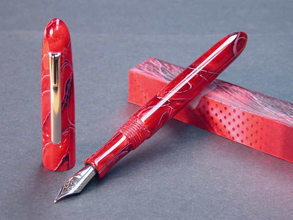

Sorry, I thought I had the right one.
Thanks..John
