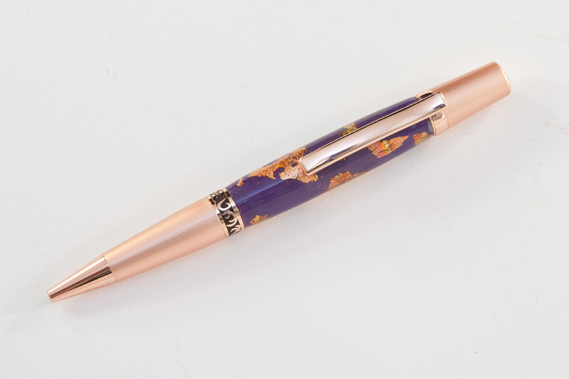

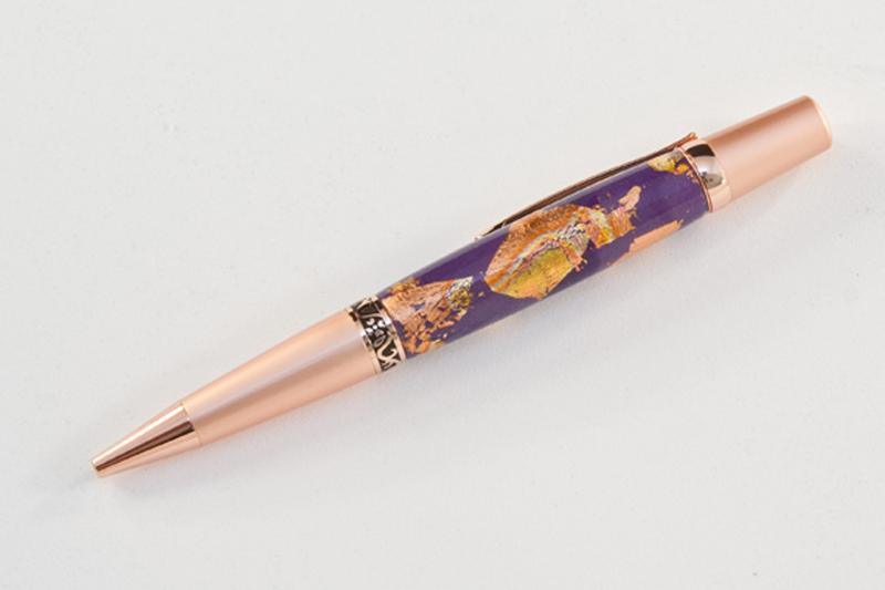

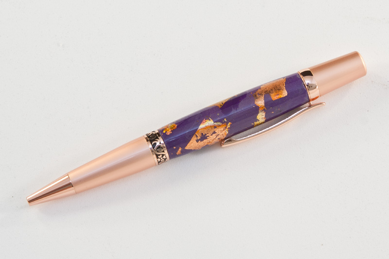

I'm always experimenting. Thought this one came out pretty good.
I always do my experiments with Sierra style pens since it only requires one piece to cast and turn.
Let me know what you think
I kinda like it. I can see someone at a show standing back holding up there chin, then making a frame with there fingers, then holding up there chin again and saying mmmmm I will take it.
To me it looks like random art. If there is any such a thing.
Gold leaf in resin?......I like it.
Close...not gold leaf though. It a variagate copper leaf.
The tube is covered in Polymer clay, the leaf applied and then baked. It is then cast in clear PR.
On the Sierra its a little tricky because you don't have a lot of thickness to work with so the PC has to be really thin.
I like! Thanks for sharring your process!
