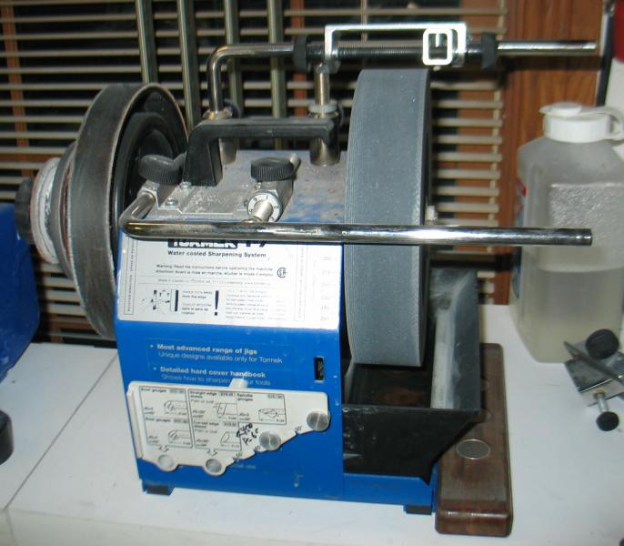

...but I second "Shock me"'s opinion -- an extra tool rest is nice. I leave one in the top position with the wheel truing jig installed. Allows fast incremental wheel truing & freshens the stone for faster grinding.
