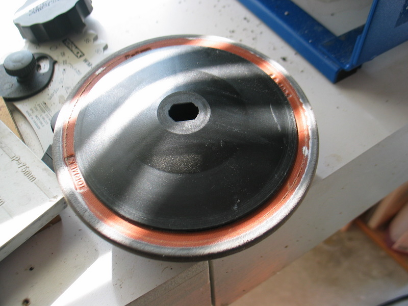

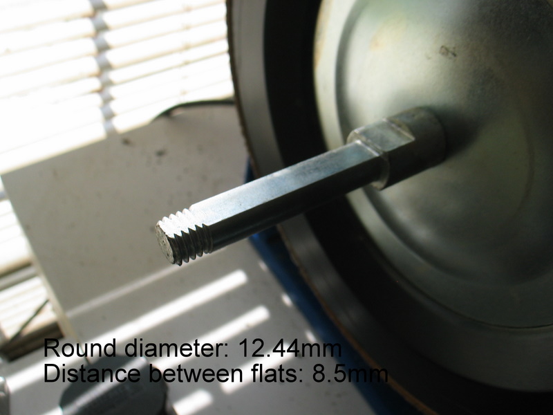

I don't have a Grizzly but my Tormek leather profile wheels fit a flat-sided shaft. Round shaft diameter is 12.44mm and flats are 8.5mm apart.
