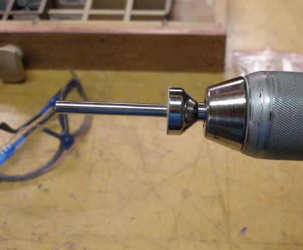

Here is the sander mill mounted in the chuck of my drill driver,

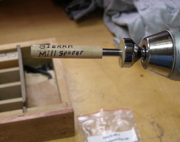

Here is the sander mill with my pen mill spacer on it. You can see the sand paper in this shot also.

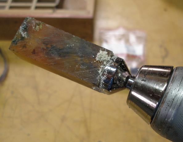

Here it has cut a PR blank. You can see all of the sanding dust from the cut.

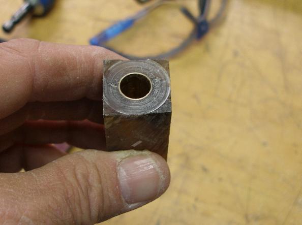

This is the finished product. Flat and perfectly true to the tube.
