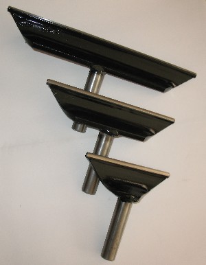

I bought a 6" Comfort Tool Rest with the 5/8" post to fit my Jet 1014VS. This is a huge improvement over the stock rest because of the stainless steel rod that is epoxied at the top edge of the tool rest. It stays ding-free, and I can really ride my skew across it with good pressure without any wear on either surface. I like the curve for the finger room, too.
These are about $48., but it's one of those vital pieces to the turning process. (A lot of "vital" pieces, aren't there...??!!!)
You could probably epoxy a 3/16" stainless rod to your stock Jet tool rest as a least-cost upgrade.

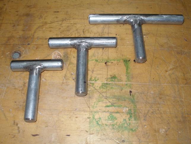

I had my BIL make me these before he went back to Oklahoma. Simple round stock I picked up at Ace and a half hour of welding and grinding. I love them.
