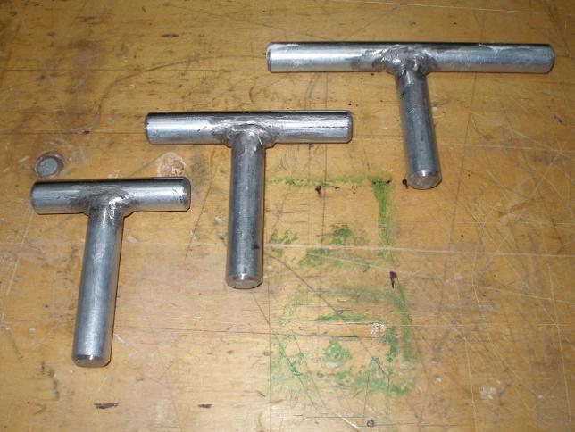

A lot of us replace our stock tool rests for custom ones. Usually round so the tools slide better. I have this set up. It also provides diff size rests for diff jobs, one blank, two blanks, or even longer work.
Any chance you know what your BIL did to make those? What type of steel will work? sizes for rest? Did he contour the support post or just butted, squared and filled with bead?

Actually, I did all the prep work and he did the welding, then I did all the clean up.
I went to Ace Hardware and bought a piece of 5/8" steel bar stock. Just steel bar. Cut it with a cut off wheel. Took the top bar and, with my 6" grinder, ground a notch in the bar for the shaft to set in. Then he welded them and I used a angle grinder to clean up the welds. Took a total of about an hour to make and cost maybe $10. Cant even remember how much the steel was.
Was easy cheesy. He even did the welding with a cheap 80 amp no name welder.
Good luck and happy welding.
PS: the rests are 3", 4" and 6".
