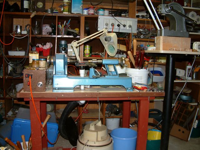

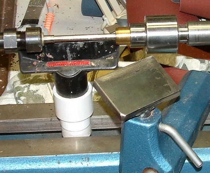

I feel blessed in that I use short pieces of steel etc weld my own. Round Rock must have dozens or more handy people like me who could weld one for you suggest a pen in exchange. I enclose a happenstance tool rest I made to use on my Vicmarc VL100 that I needed to clear the Vac tube I fitted thru the rails. Surprise and lasting happiness cause this accidental angle allows me to rest the chisels flat, no more chatter etc and lasting comfort whilst turning. Sorry you are so far away for me to help other than show you my experience with Custom Made toolrests. Have success Peter.
PS This bench of mine welded steel etc I made to sit at on a highish drafting swivel chair not cause I have too but it is very comfortable. Noticed the terms no more colleywobbles that refers to my nesting the mandrel in the live centre doing away with the point in the end of the mandrel as I have done for ever it seems.
