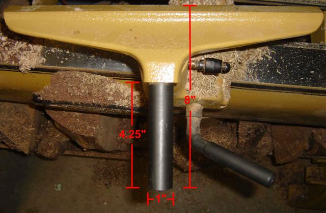

<br />Billy, what are the dimensions of the post?? Length & height and post dia.?? Just curious because I have to rebuild some for my Delta with the lift going on it.
Lee, I decided it was best to answer with a photo.
<br />
As for length, I'd like a 6" and possibly a 4".
