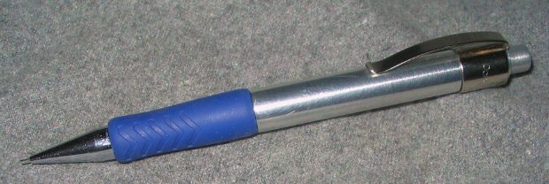

I'm having more fun learning to use my new Taig lathe. It's small enough that I can carry it in the motorhome, and turn pens as I travel. Shown below is my first pencil, from 6061 aluminum. I wanted a pencil shorter than a Pentel, fatter, and with a rubber grip. The tip and mechanism are from a Pentel Forte, the clip is from a Pentel Capri ballpoint pen, and the blue grip is from a give-away pen. Overall length is 5 inches.
Your comments please......

Sweet. Very cool Bob. Hope to see more of your turnings soon! Congrats on the new toy!

Your pencil shows you are well on the way.
