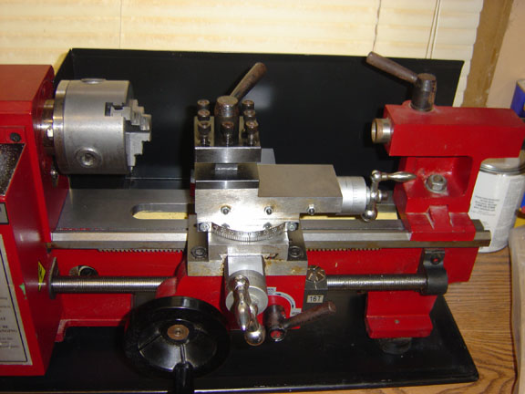

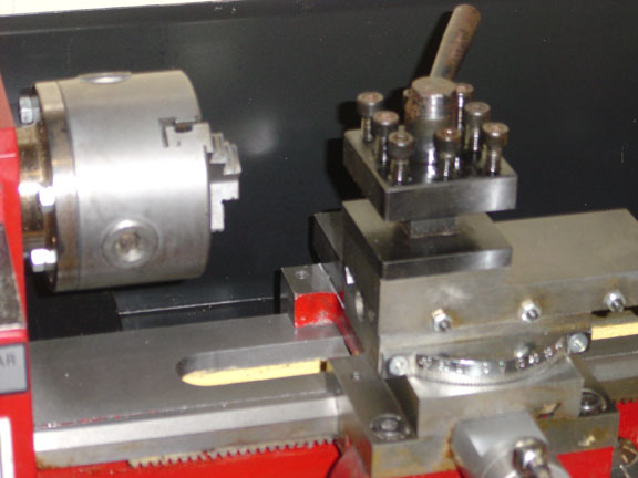

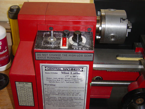

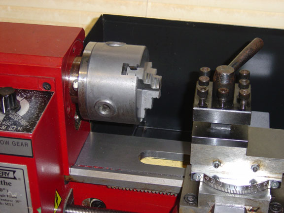

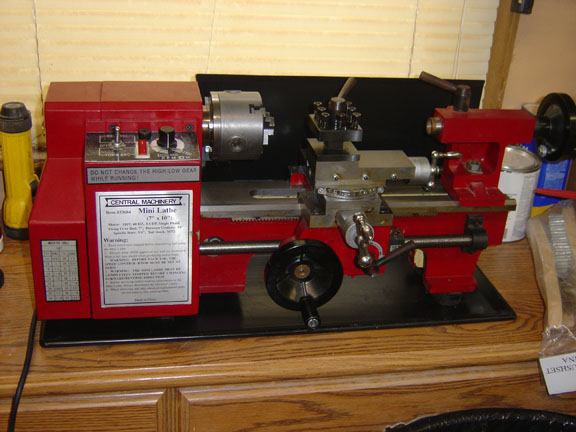

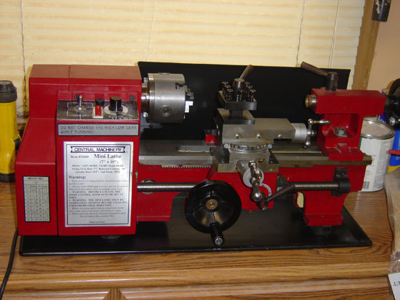

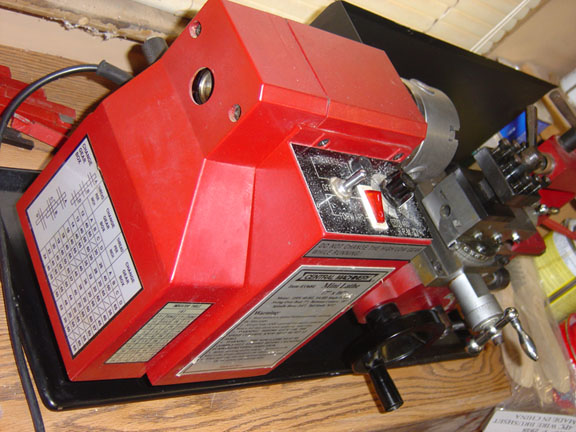

I took some pictures after I cleaned it up today. What do you think?
I finally got the threading gears from The Little Machineshop and put them in to finish testing the lathe. The threading test was a total failure. There was some serious binding in the carriage handwheel assembly. The binding was causing gear slippage.
So, I took the lathe carriage assembly apart and cleaned it with lube until it turned freely. Moisture had gotten into the rotating parts causing them to partially seeze.
The lathe is fully operational and tested!! The good part is, I only have $110 in total cost of the lathe!! ($30 for lathe and $80 for gears).
:biggrin: :biggrin: I am a happy camper tonight!! :biggrin: :biggrin:
