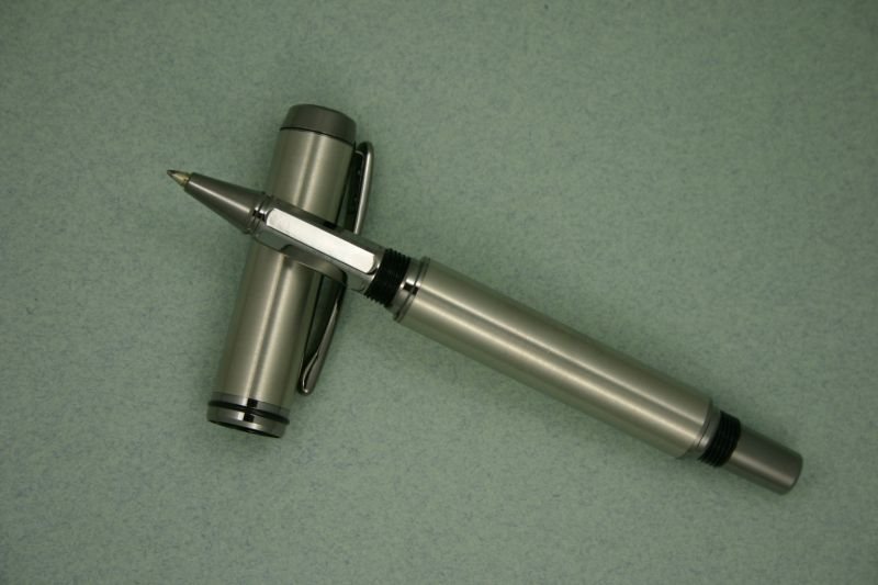

Just got done taking pictures of my first Black Titanium Baron in Titanium metal. The combination of the Ti metal with the Black Ti hardware really looks good.
Hope you like it!!

Details! We want details. [:)] Did you start from solid bar or tube? Is it 6Al4V titanium or CP? Are you going to sell it? What do you think it should cost?

<br />Pretty "sweet" looking Rudy---very nice!!!! How long did it take to make it??
About 5 hours! The problem for me is the drilling of the rod on my small HF 7x10 metal lathe. Turning and the cut-off of the barrels was not so problematic.

<br />Details! We want details. [:)] Did you start from solid bar or tube? Is it 6Al4V titanium or CP? Are you going to sell it? What do you think it should cost?

It is made from CP Grade 2 Ti, from solid round bar (0.75"). Yes I will sell it (if I find someone who is willing to pay the price I want, I think somewhere in the $200 area would be fair).
I took me about 5 hours to make, and as I stated earlier the main problem for me is the drilling of the holes, not so much the turning. First I drill a small hole, that I successively open up to the proper diameter. I will look at anodizing in the future.
