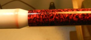

Ok; Pics follow.
This post is only to show how I dealt with this situation. The blank is REALLY beautiful and I want to complete it. The depth of the blank is amazing!

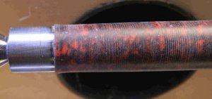

This is the blank showing the small white pits. It really stood out on the red blank.
This is after finishing. I applied Red Transtint dye to the blank to subdue the white spots. Then I put thin CA as a finish. Not up to my usual finish standards. I will retry the finish.
I suspect the "white" is actually acrylic sanding dust caught in small pits in the surface. If you don't clean them out completely (which can be difficult), then putting a CA finish on top will simply trap the dust there.
Tinting the dust to match the blank sounds like a novel and effective solution.

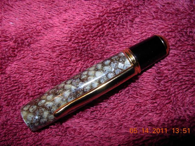

Had something similar happen with a snake skin blank.
Tried filling with CA and it didn't help, so I tried sanding down as far as I dared (I didn't notice the hole until after final assembly, so I had to take the pen apart). Once I got down as far as I dared, I noticed that the hole went a bit deeper than I'd initially thought. Tried to vacuum out the hole, and fill with CA, but the results weren't all that great. Probably got some CA in there from the first time sealing some of the white in. Don't think there's much I can do now, but I'm sure it will still look decent. Pretty sure it was a bubble.

Ghost, A snake skin blank is made from either PR or Alumilite and can have voids, whereas an acrylic blank is made under much more pressure and very,very rarely has a void and I agree to a certain extent with Eric and Landon that the white spots in the voids were sanding dust and the voids were caused by tooling not caused when cast now to PR and Alumilite voids happen as I stated but the effective way to "hide" the is as Eric said do not sand and fill with CA. In my opinion you do not ever need a CA finish on any acrylic or PR but on most alumilite blanks you do....
Ghost, this isn't exactly a fix to the problem. It looks like that is a sierra kit so you could knock out the end finial and switch it to the other side so the clip can cover the filled in hole. Since both sides should be turned to the same diameter. Like I said, it's not a fix, but it can take the eyesore away and that is a beautiful blank.

Yeah, I know (and I do appreciate the advice). Unfortunately, that blank also has a pretty bad crack (more like a lack of adhesion to the skin) dirrectly under the clip at the edge of the blank, so it actually looks better this way. If I turned it around to the back side (opposite the clip), they'd both show. I just accepted it as one of those things that has no remedy. I already sought the advice of a quality pen turner in my area, and received the same conclusion. Of course, that doesn't mean I'd discount any ones idea if it worked. Short of making it disappear, I don't think it can be helped.
