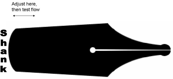

attachment.php
To tighten the fit against the feed and within the collar, simply flatten the arc of the nib at the shank end. Do this with your fingers or if you have nylon jawed pliers you can use them. The amount of flattening needed is tiny, so adjust and test until you get a good fit. Afterwards, you will need to adjust the ink flow. See the article in the Library for details on adjusting ink flow.
Make sure that the nib is centered on the ink channel when you are done .
Look in the breather hole on the nib with a bright light and a loupe and you should see the ink channel in the center of the hole . If you don't carefully reset the nib until it is centered .
