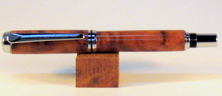

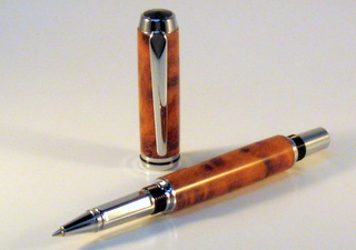

Here's a Chrome Baron wrapped in Thuya Burl . I tried a CA (only) finish a friend wrote out for me , and was pretty pleased with it . It is a little proud at the finial end , and there is a small chip where I took off the bushings . The photos are still an issue for me , as they still don't look focused . At least they're not grainy like the blue Sierra .
Thanks for looking , and as aways , comments are welcomed ! :redface:

Thanks Kenny . I think I'll try to add this one to my album here . I had some issues with ridges but it worked out as I progressed . I'll get more comfortable with it . Thanks for the demo too !
Thank you Heith , Dave , Neil and Steve . I appreciate the support .
Steve I agree , I thought they would be bigger when you click on the thumbnail . I'll check into it .
Looks great! Don't finish with the bushing on, that'll prevent the chip out. I just finish between centers only. A drop of CA on a baggy, then dip the chip area into it, that'll fix it..with some sanding of course. I do love Thuya...but the smell gets old fast!
Thanks Jeff , if this happens again I'll remember that repair step . I coat my bushings with wax before mounting , but it just didn't work with this method , or I was a little too agressive in removing the bushings . Turning between centers is coming soon for me though .
