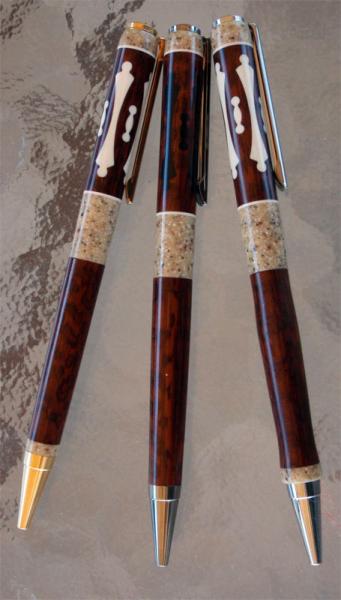

Just finished these three Slimline pens.
Snakewood with Corian bands.
Ivory inlays.
Hard to see the black Micarta inlays in the center one.
They dont stand out very well in the Snakewood.

Hey Willee,
I didn't realize you made anything other than cues:smile:. Them are some mighty good looking pens.

Is there a special punch to make those shapes?
Those are very cool slimlines!
They are done on a CNC milling machine designed for pool cues.
Some of the smaller designs I use in both pens and cues.
I rarely use Ivory inlays in a pool cue (too expensive) but in pens the smaller pieces sometimes are worth the expense.
There are other white materials that come close to the look and feel of Ivory but nothing beats the real thing.
Those are awesome. Are you worried at all that the Snakewood might crack?
Snake wood is very hard and somewhat brittle.
I guess that is why it cracks easily.
The wood I have is not a real good grade but it is well aged and the blanks were cut about a year ago. I also apply thin CA to the inside of the tube hole and let it soak into the wood to help stabilize it before gluing in the tube.
Usually they crack during assembly if the part I am pressing into the tube fits too tightly.
The tube will expand and the Snakewood will crack.
Once they are assembled I haven't had one crack ... yet.

Yeah, it can take a looooong time for Snakewood to crack. I'd hold onto them for over a year until you're certain. Even then it's no guarantee it wont crack later. It's something to do with the snakewood changing shape while the brass tubes don't, that's the theory.
The pens look great. Normally I really.... really... really don't like wood and corian mixed but those are very good looking.
