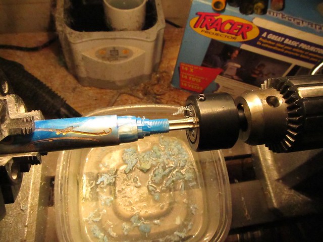

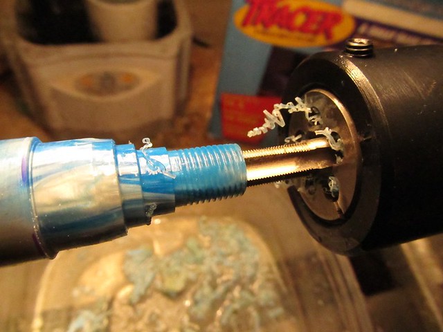

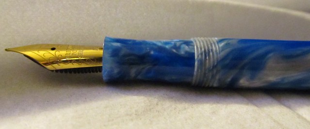

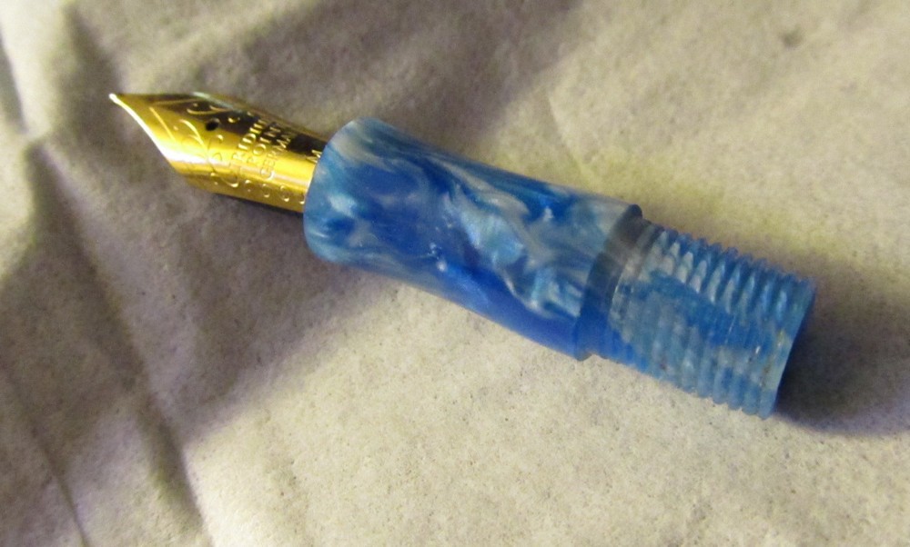

Dunno if this has been done before - or if this is old news and I'm just discovering it all over again - but I'm turning some PR tonight that I got from Scott at the Central Arkansas meetup today, and as I was threading the 10mm threads that go into the barrel, it started to crunch - so I pulled the die/die holder off and looked at it. It's nice and warm with the 120W lightbulb inches above it - it's got a nice layer of oil on it....
DUH!!!
I put the tap for the nib unit all the way in, so the tap supports the thin tenon, and I cut the threads front to back no problem!
YAAAAAY!!!!
007 by snennewton, on Flickr
008 by snennewton, on Flickr
Any questions I'd be glad to try to answer.

So... lots of heat helps, and for tiny parts, leave the tap in there.
It looks like you use the collet method, so you could also put collet, blank and all in the toaster over at about 140 degrees for about 15 minutes after drilling, but before using the tap and die. Add a little PAM and PR gets a LOT easier to thread.

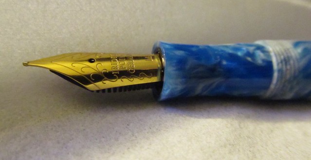

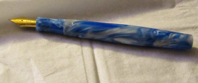

Did this in the 4 jaw chuck - once parted off I put it on a holder in the collet chuck. Finished drilling, then turning down. Polish - and here it is!!

I wrecked 2 sections when I tried to tap the external threads after the inner ones. :eek:
Then the lightbulb went off and I started cutting the outside thread first, then drill and tap the smaller inside threads. :rolleyes:
It is just a matter of getting the sequence of operations figured out to minimize rejections. :wink:
Yes that's how I do it, in addition I usually make up a spare threaded collar from PR to fit the outside thead and put that on to support the thin wall.
I have always found that the courser a thread the earlier it should be done
I do the M10x1 for the grip first
the turn the outer diameter to 14mm insert the M10 tap and tap the M14x).8 tripple start
fine threads require less torque to cut as they are not so deep..

like others mentioned, I too first cut the outside threads, then the inside.
since the taps used are usually taper taps, the cutting edge engages slowly, over 4-5 revolutions, which stresses the plastic less. the die, on the other hand, have a short taper of only 2-3 revolutions = more stress on plastic.
I've seen people cut outside first, but even with a tapped support piece screwed on, I ve had lucite crack doing this. I've done better with inside first - still screw a support piece inside. I used the tap too, but if you ever get to larger inside threads, you would need to make a piece for the support if the tap wont fit inside the die holder.
Alex, you are completely correct about Dies being more agressive than taps, but there is also the consideration that a circle with even pressure all around it from the outside is much stronger than pressure from the inside. Most materials are much stronger in compression than in tension. Think about how strong an arch is in architecture.
Bottom line - try both ways and do what works for you!
I like the idea of making threaded inserts to put inside the piece being cut with die. Hadn't thought of that - even after using the tap on this section. It's funny how the answer is right in front of me and it doesn't click sometimes. :)
