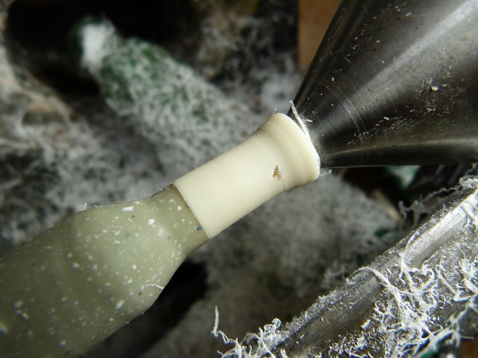

Well, I got one of the alternate ivory blanks from Exotics to thread pretty good. One little chip, but really small and near the edge of the threads so I pressed on. Got all the various holes drilled to the appropriate depths to allow the feed housing to insert and screw in snugly, then during shaping, this bubble showed up that was almost all the way to the internal chamber. Ugh! Have another one on the lathe now back at the shaping stage. Fingers crossed there are no internal voids in this one. Talk about taking the wind out of your sails. It's all part of it though. Learn from mistakes, right?
