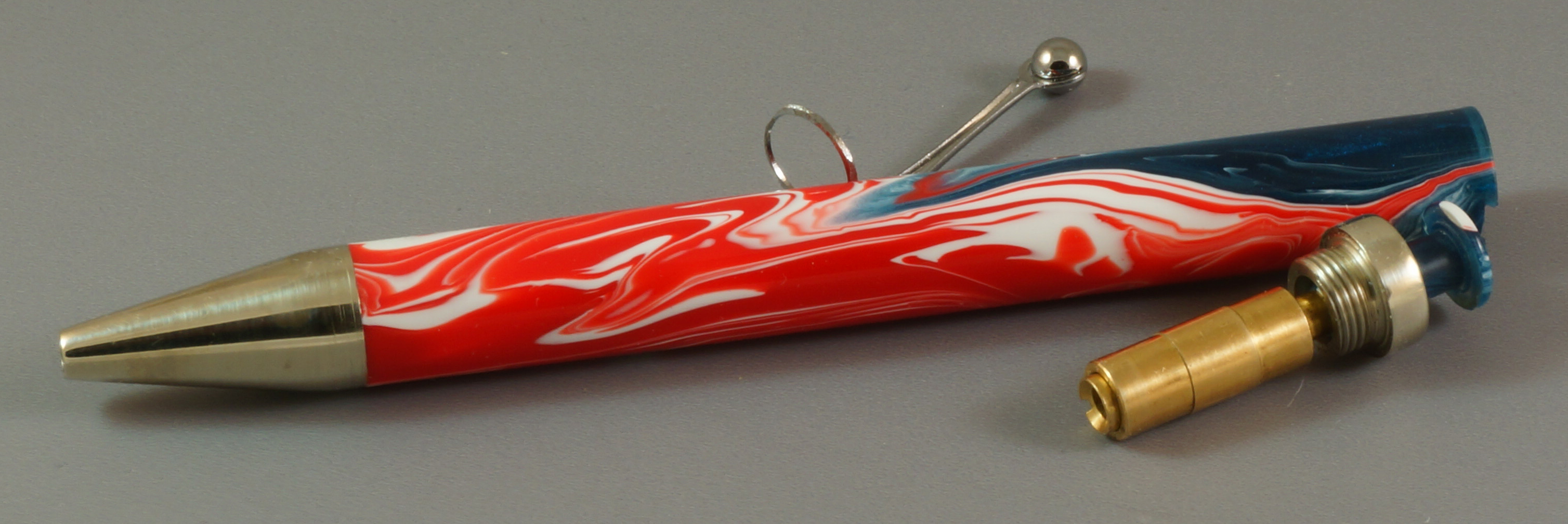

This is a follow up from my earlier post. This was a PITH exchange pen from 2016. I had to find the pics because I never posted it myself. It uses the internal bras mechanism from Richard Greenwald. Since it's internal, I can make a longer pen than when using the external mechanism. I think the nosecone screws on too, but it doesn't show in the picture.
View in Gallery
I had a lot of fun making this pen, but I do have a small metal lathe which helps a lot.
Nice pen, Bob !! . Very attractive indeed !
Looks like you have made an extender for the click mechanism in order to get the overall pen length you wanted . . Neat !!
I also like your customized button !
Yes, indeed, it sure helps to have a metal-working lathe ... that's all I ever use.

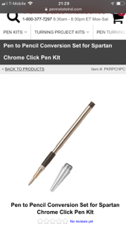

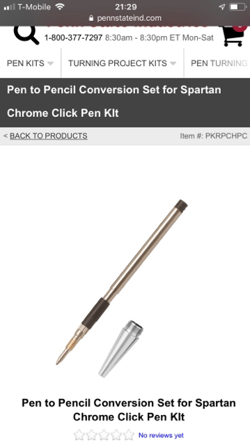

Hi guys. This part is exactly what I'm looking for. Is there a place that y'all know where I can just buy that tip? I guess 4 bucks isn't so bad but I really don't need the pencil attachment
Pennstateind.com is the chief supplier of the Spartan kits . . I doubt that you can buy just the threaded nose piece . . But you never know . . If you were to phone their customer service number (they do not respond to emails) you might be able to talk them into it, especially if you have a history of buying from them in the past . . You could even make up a story such as ... "I have some of the Spartan kits and I have lost the threaded nose cone(s) for a couple of them. . Is there any way of getting those parts replaced ?" . . Get creative !!
https://www.pennstateind.com/store/PKRPCHPC.html
