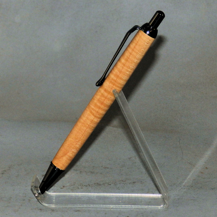

I recently completed one Dawn click pen kit. I bought the kit from Exotic Blanks and I believe it may be available from some other sources as well. I am reasonably happy with the outcome, but there are some things that may be helpful for anyone else who is making or considering this kit.

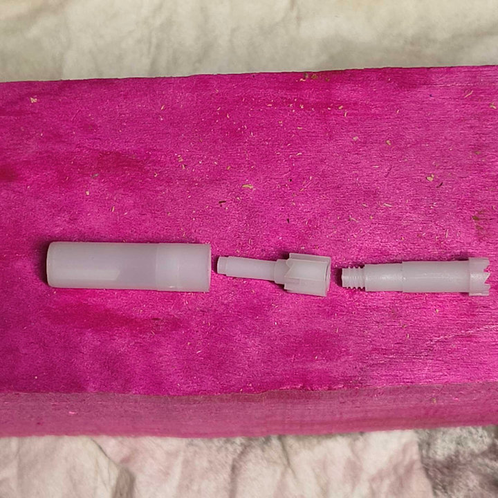

There is a plastic sleeve in the click mechanism. This is installed in the bottom end (nib end, writing end) of the pen and must be installed before the threaded insert that holds the nib.
The instructions say to use the refill or a tool and push it all the way to the other end of the barrel. This is where I ran into a problem. I installed the other two click components and in pushing this assembly to the other end, the pieces jammed and would not operate properly. I got them unjammed, but then had trouble getting them to all fit together properly. I pushed the sleeve back to the nib end of the pen, but I had already installed the threaded insert so could not get it out to see what was going on. I then pushed the sleeve back to the click end of the pen, put the other two pieces in and after a bit everything started working correctly. Bottom line here is two things;
  1. before assembly, lay out the plastic parts on the bench and see how they fit together.
  2. if possible, push the sleeve through the tube with a transfer punch or other tool, not with the plastic click parts already installed in it.

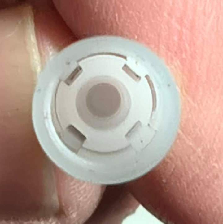

Subsequent investigation shows the following. The sleeve has four bars molded internally which engages four slots in the bottom plastic piece. Engaging these together is made tricky because there is also an interference fit between the bottom plastic part and the sleeve, presumably to keep the click mechanism from falling out when you replace the ink infill. Aligning the slots and bars while pushing through the interference fit is tricky. I'm sure other pens are similar.
Below are the click parts - I have the two on the right laid out in reverse order :rolleyes: - sorry.
After I got the pen assembled and put together it clicks very nicely and repeatedly.
