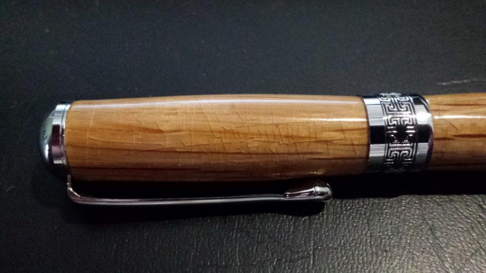

This really hits home. I am in the middle of a CA conspiracy. I've had problem after problem for the last few weeks with cracking. I JUSt redid the same pen, three times, with different, new, Stickfast CA every time, and cracks just appeared today.
Here's what it looks like 3 days after finishing:
I've used thin and thick, with and without accelerator.
I am going to change brands now and see if that helps. BTW, I have made hundreds of pens without trouble. I had an incident early on but that was fixed with getting newer product. These last few weeks have me pulling my hair out. It's not been on every pen. The one pictured here was done side by side with another just like it and that one has no cracking.
