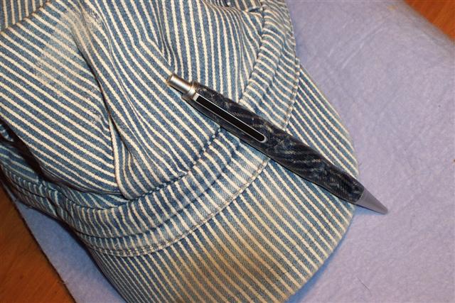

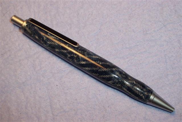

I have been wanting to make a WGAS pen to carry for a while and I always wear an engineers hat.I never throw th e old ones out I have a closet of them.(the bills are worn but the cap is O.K.)
the components are Gelwriter pro click from Woodturningz.The method is the same as I do for denim blanks but I made this a one piece.

As usual, very good work with a creative thought. Makes me want to break out in song - I've been working on the railroad. Thge shape has to help with the feel when you are holding it.
C'mon now Blind Squirrel, ya can't quite be that blind, lol. It's a <b>Gelwriter pro click from Woodturningz</b> jus' like he said .[;)]
Nice work there eagle. I have a bunch of old silk ties that I'm eyeballing.

Very nice Eagle. Now I have to add cloth pens to my list of things to try this winter. Is that a satin finish on the pen parts?

NOt sure of the plating on the components,it is a satin and it's silver.
I went back and looked, the first demim pen I "home rolled" was in January of '05
Since then, I have done the same concept in different cloth materials.
I have also done these in verigated tobacco twine, cotton butchers twine,ribbon from Wallyworld, newspaper, sisal rope and others, the possibilities are endless.
I do not cast these in acrylic, when you are turning this type of blank you are turning off the material along with CA.
Important note! <b>CA DOES NOT BOND To EVERYTHING!</b>
When I first tried the sisal rope pen I mistakenly bought a "faux" sisal that looked and felt like the real thing but was made out of polypropelene.BIG MISTAKE!
Certain"blends" will work but try to select a material that has is mostly made of cotton.(I imagine any material that is orgaic would work, but there was a recent thread where someone tried CA with certain types of feathers and had difficulty,I am guessing the oils in the feathers had something to do with it.
(Of course if all you are doing is cast it in resin the composition of the material won't matter)
As in casting I don't have any control with patternd materials, that is part of the fun with these.You can experiment with laying in the materials using different "shapes" and it alters the way the finished blank turns out.That explains the change in direction of the stripes on the railroad hat pen.

I have made a lot of pens with this method and the selection of the material is not always that easy.
One thing that I always consider is the size of the pattern and how often it repeats.This will have an important effect on the finished pen.

What I don’t understand is why the fabric looks like it was compressed. I’m going to have to wing making one myself, just don’t really know my plan of attack yet.

After you are done turning it, how do you go about sanding/finishing it? (How about a picture tutorial on the entire process? [:D])
I actually have written how to do this, getting my daughter to take the pictures is the hard part.
