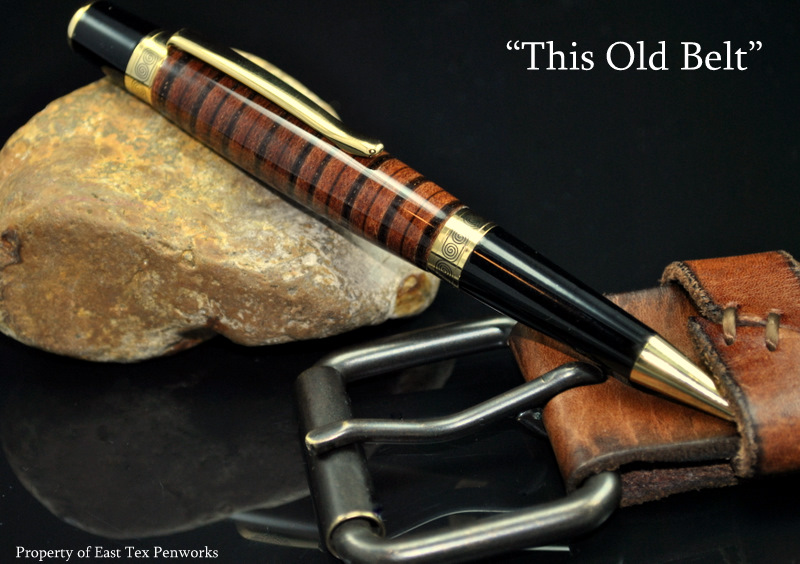

Well, when my fiance found and old belt of mine,the light bulb went off!! Perfect time to try a leather pen. I don't know if it's leather anymore. I think it is just CA. I cut 1"x1" squares. Started with CA on one then, applied to another and so on. Saturated it over and over with thin CA. Drilled hole for tube. That actually went pretty easy. I started turning down. Once round, I would stop and pull off lathe, saturate with thin CA again. This went on until I finished shaping. Sanded 320-600. Applied 5 coats of thin CA, 10 coats of Medium, 3 more coats of thin CA. I wanted tomake sure I didn't have any voids because of the leather being so pourous. FINALLY! Sand 600, wet MM to 12k, Hut and Ren to top it off.
This was actually fun because I really didn't have any idea if I was even close to getting it right!!

Nice job! I just finished a couple of leather pens myself in the last few days, got a new on on the lathe as we speak. If it wasn't so darn hot out there, I'd be turning it rather than typing. I don't know if I'll invest the time to get the finish on mine that nice though, I use them mostly on bullet pens or paired with antler, so it's ok if they look a little more "rustic".

Hope you have a gallon of CA! :bulgy-eyes::eek:
I really like this pen. Looks fantastic. Great shot too - or great fixing up. Could you increase the thickness of the CA as the process goes along? I really think you should work on a couple more of these! : ) And then you might be willing to part with one!

Actually, I don't tend to use that much. I have a gadget that I made to cut out leather disks about 5/8 inch and stack them, so I don't waste as much glue. If you're interested, I'll post the process and some pics.

Heck yea! I would love to see your process. I'm gonna have to find some more belts!

Shawn,
Absolutely stunning job!!!
Did you stack the washers "cross grain" intentionally?

Yes, I tried to make sure I had defined lines. Thanks for asking! I am going to work on a black/brown one but scared the dye in the black one will give me some problems with CA.

The CA isnt really as caustic as PR or something like that so I doubt it'll give you a problem with the dye. I'd give it a shot anyhow.
