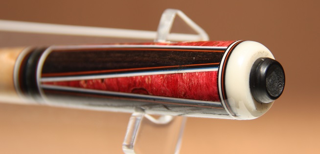

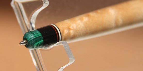

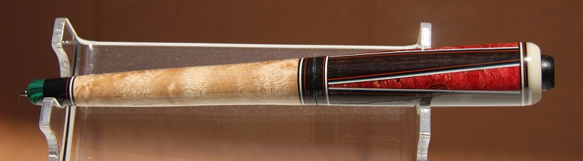

This is the pool cue pen. The DVD is out and it is excellent but the class was even better. If you ever get the chance take his class. The first pic is the full cue, the second is the tip end (chalk) and the last is the butt bumper. Here is the reason you save all those little cut-offs. The bumper is ebony or african blackwood, the tip is truestone. All that is needed is 1 to 3/4 inch square and about 1/4 to 3/8ths thick. The mechanism is a slimline. The tubes are from a euro (ie one longer than the other)
