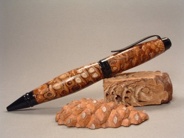

I thought I was going to be trying to make a dragon hide pen, but this is how it turned out. Not what I was expecting, but pretty interesting.
<Edit: Sorry, changed how the picture was inserted to get a better pic>

Dave, Cav pointed you in the right direction. Karl's Dragon hide blanks really caught my eye. Then I (almost literally) stumbled onto a couple of unopened Pine cones that looked like they might be able to hold up to being drilled and turned without being stabilized, so I decided to try them out. I just kept soaking the blanks in thin CA as I was turning them and they held together pretty well.
The Pine nuts that were still in the unopened cone are what makes the interesting patterns - the ones that pull out from cutting the blanks or while being turned I filled with thick CA and are dark colored, the ones that manage to remain in place are the light colored ones.
Not what I was expecting at all, but pretty unique.
if such a thing as dragon hide existed, i think that would definitely look similar to it. that's one of the coolest pine cone pens i've seen. nice work.
Doug, that is a great looking pen, would I be wrong if I guessed it was from a Pinion Pine tree? Now I know what to do with all the pine cones in my yard :( except they are from a hybrid pine tree, still might try one. :D:D
That would be a good guess Ken - that is a native tree here, but these were from a kind of Pine that I don't know for sure but they don't produce the Pinion nut. I walk by them every day at work.
The thing about them that caught my attention was that there were some cones that seemed very dry, but not opened. I don't think I have ever noticed any like that before, but it made me think that they were good possibilities for turning a pen from.
