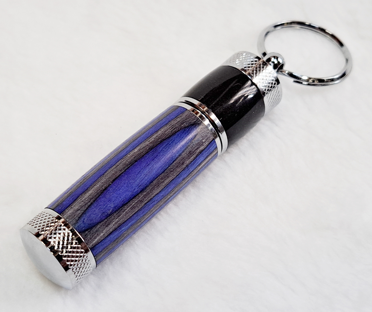

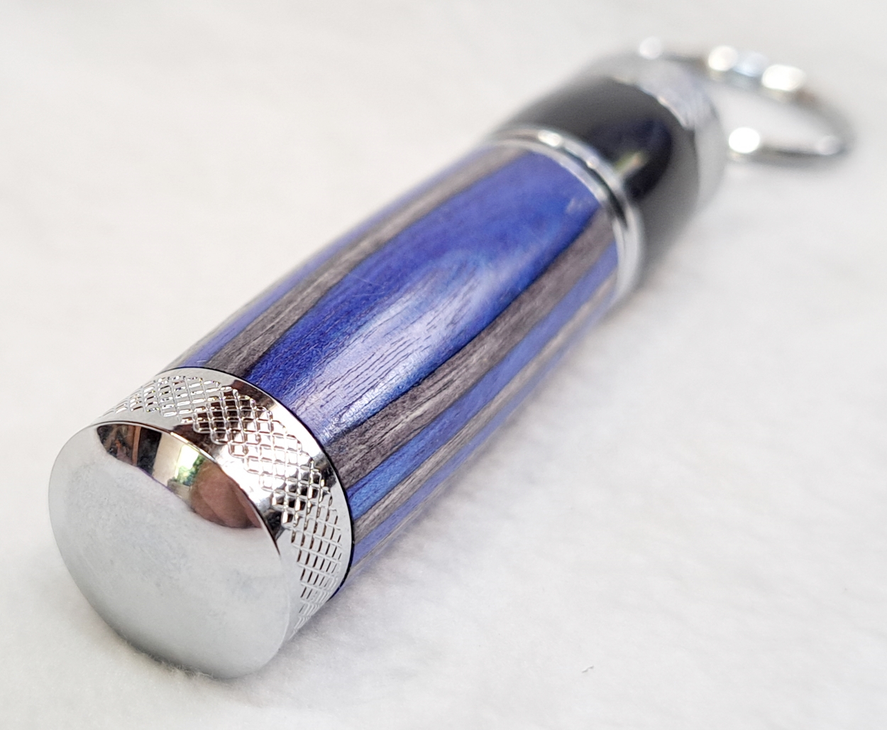

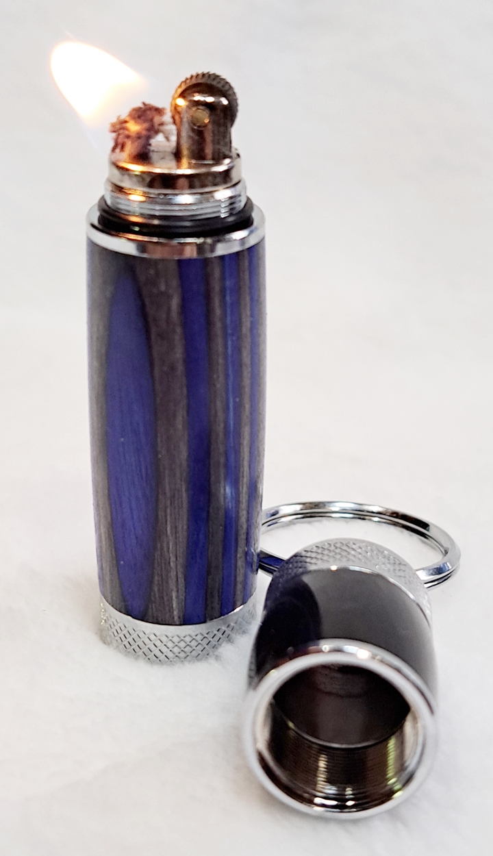

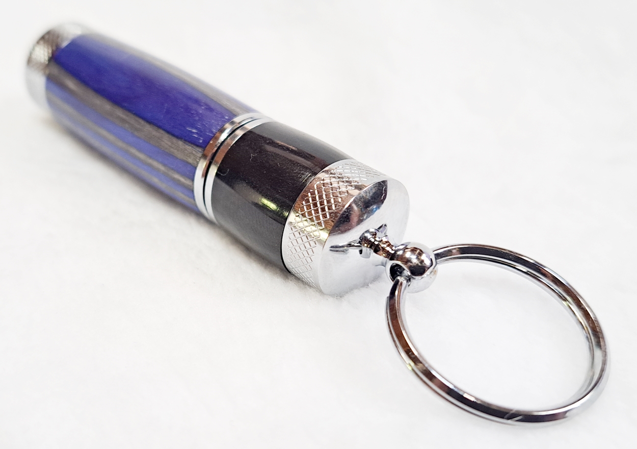

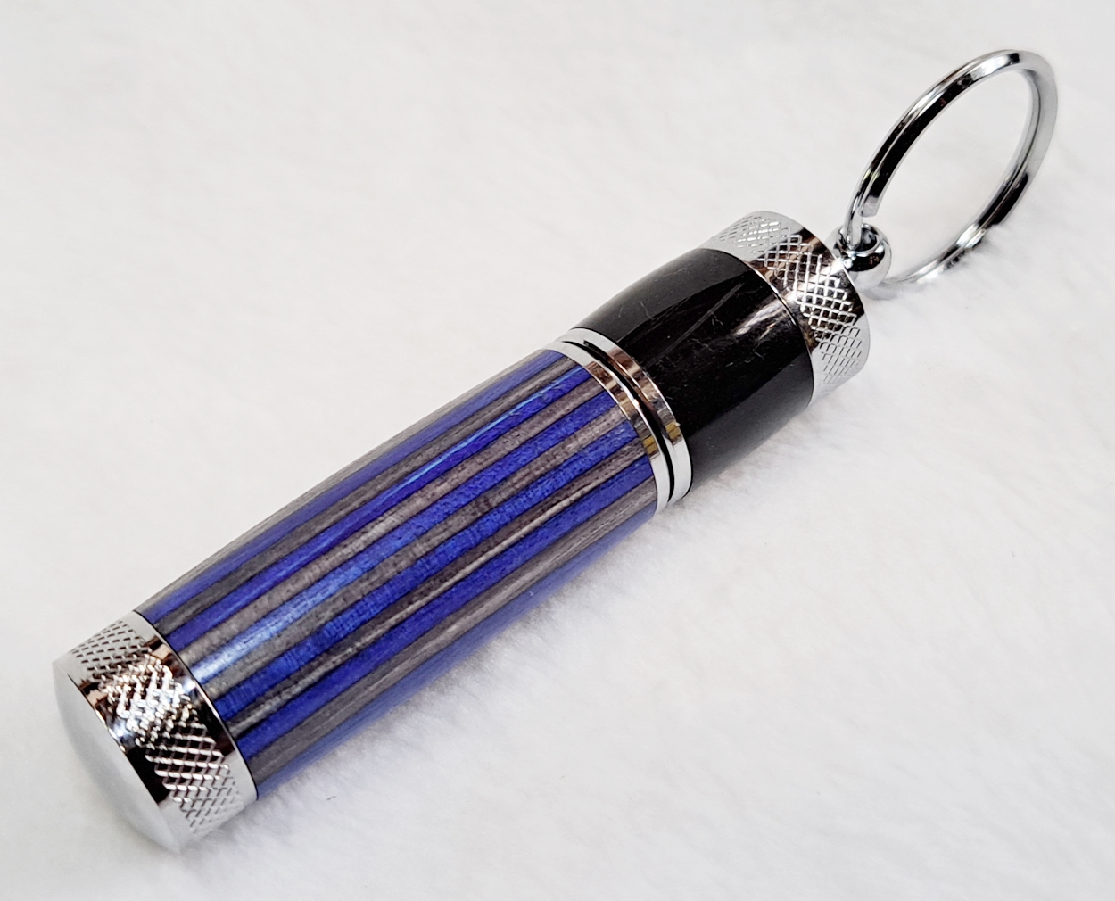

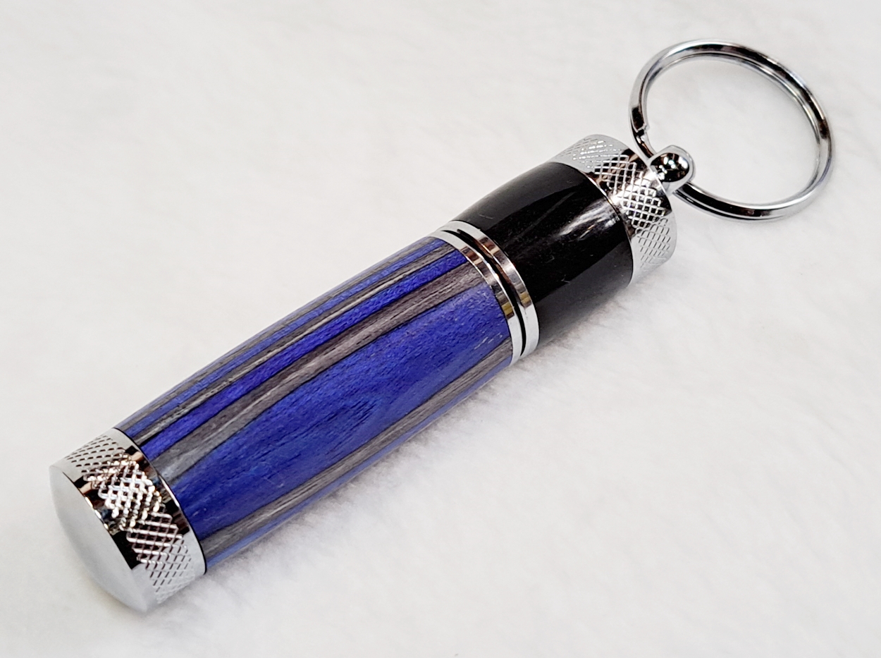

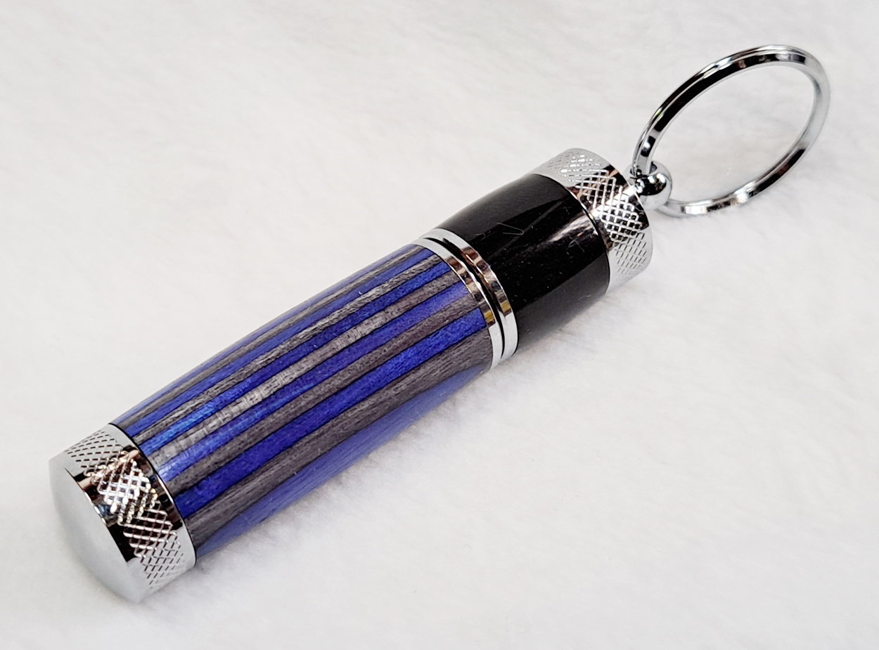

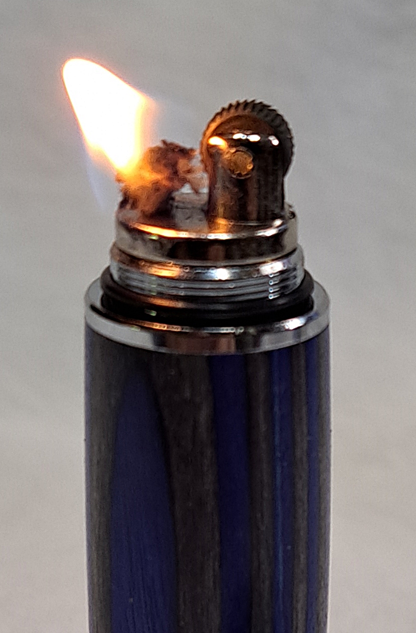

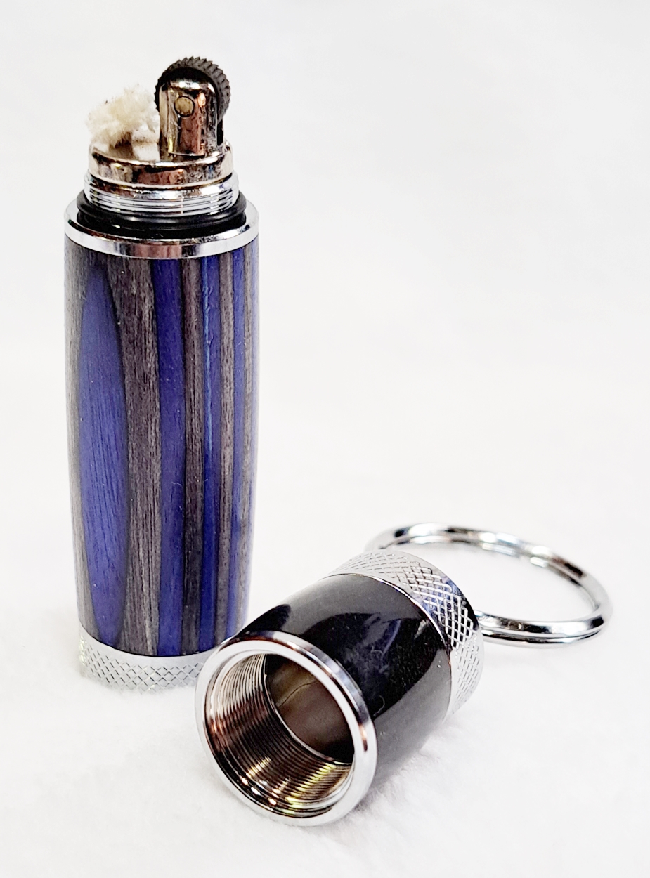

Third Lighter Keyring
See more from qquake
qquake
Feb 8, 2004
5,057
Northern California

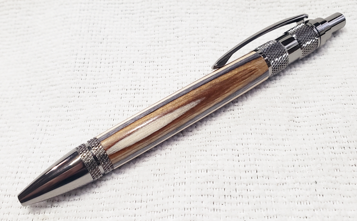

My third and final Lighter Keyring in chrome, from Woodturners Catalog. The bottom section is SpectraPly called Blue Angel, from Woodcraft. The top section is a Rhino blank called Coal Mine, from Exotic Blanks. The finish on the SpectraPly is Mylands Friction Polish. The Rhino is 220-600 wet; 3M Zona wet; and Meguiar's 105 and 205.

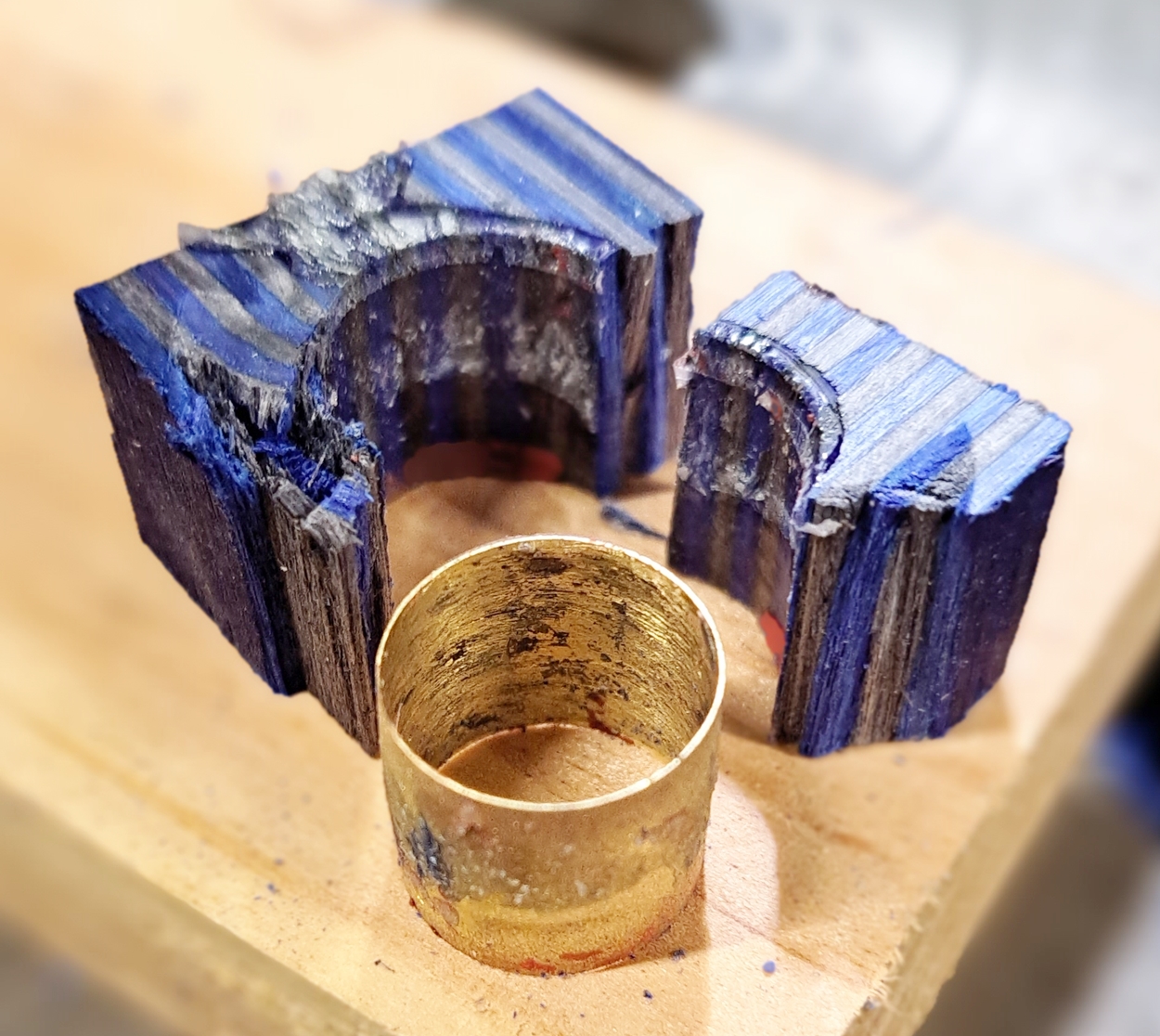

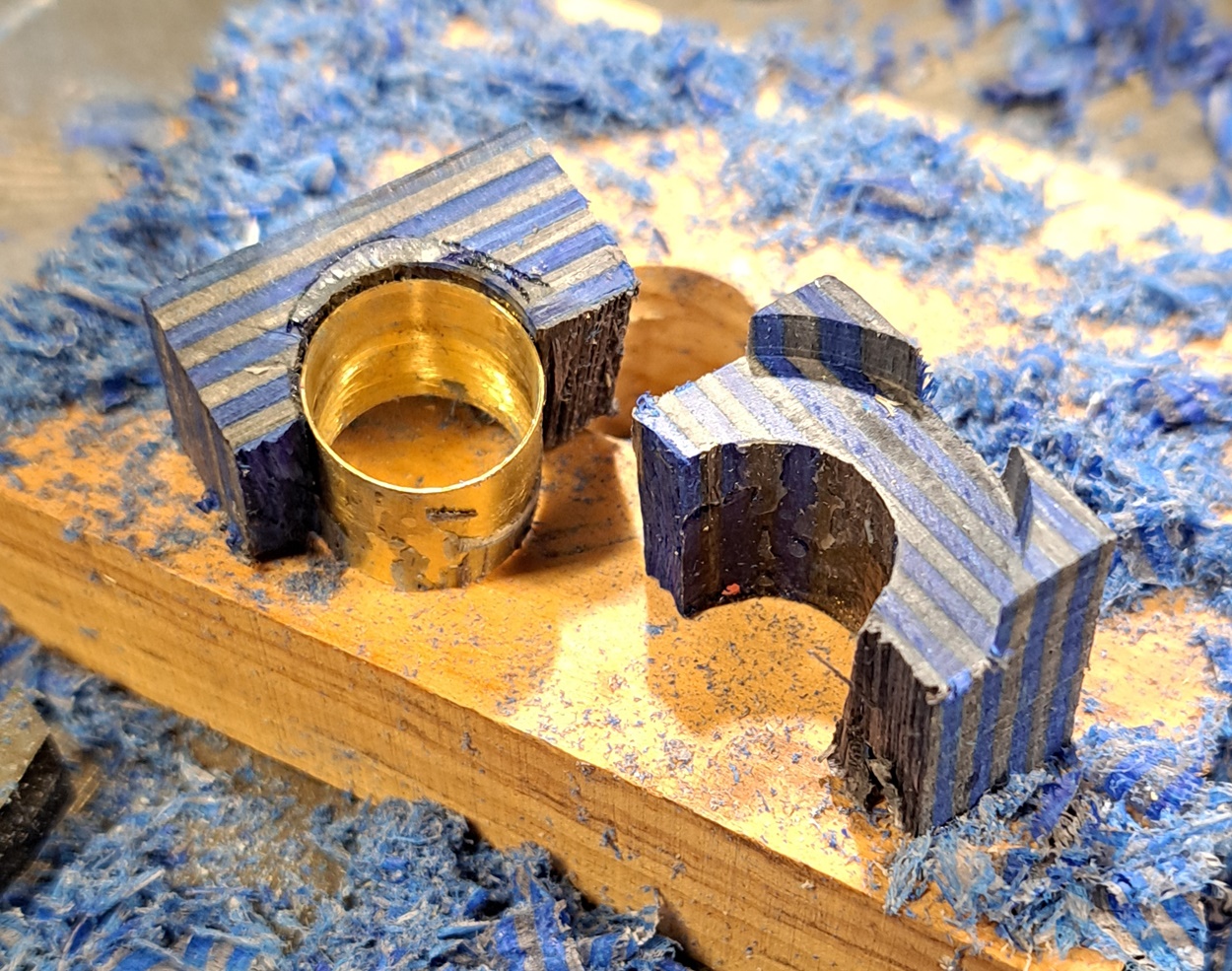

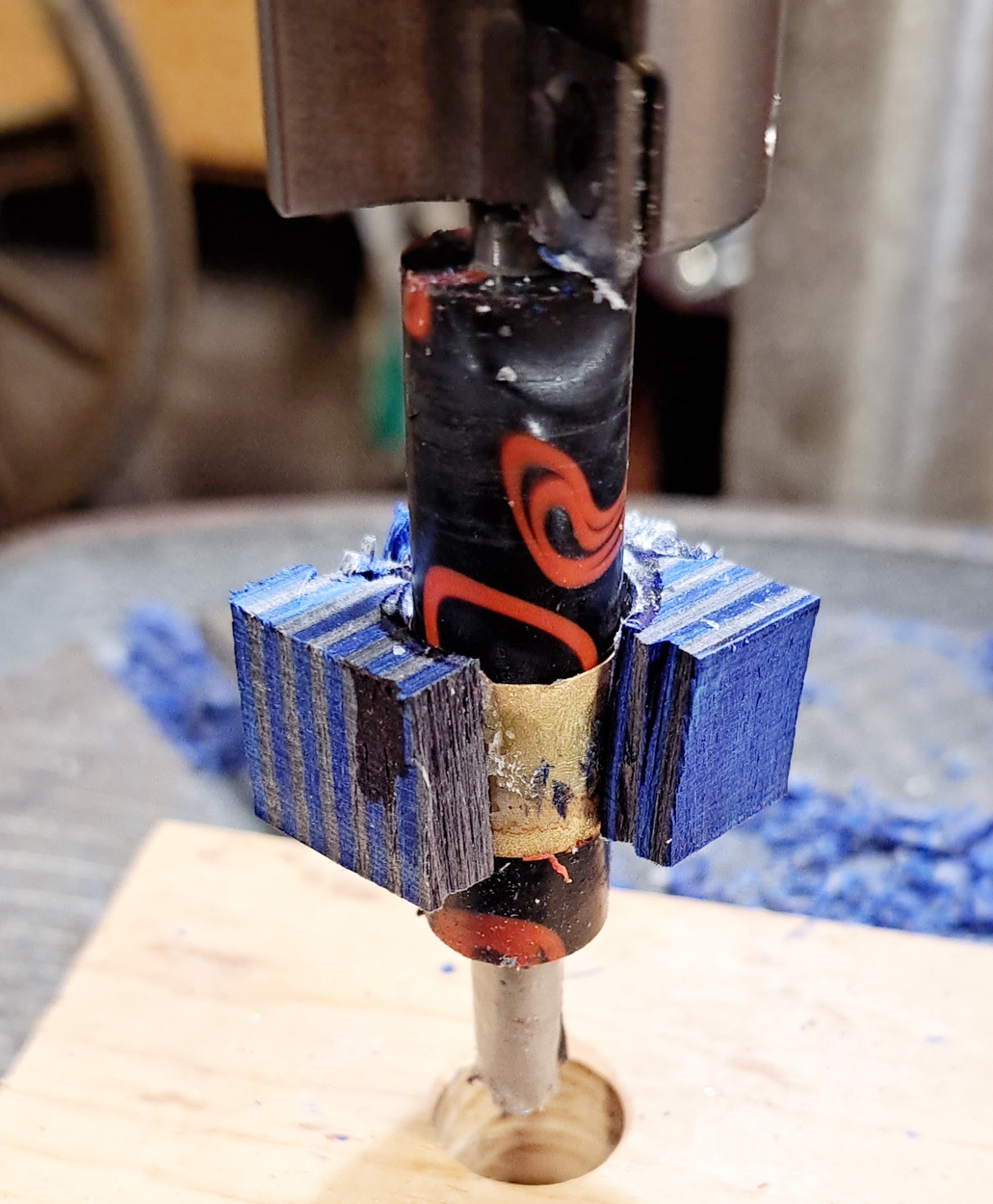

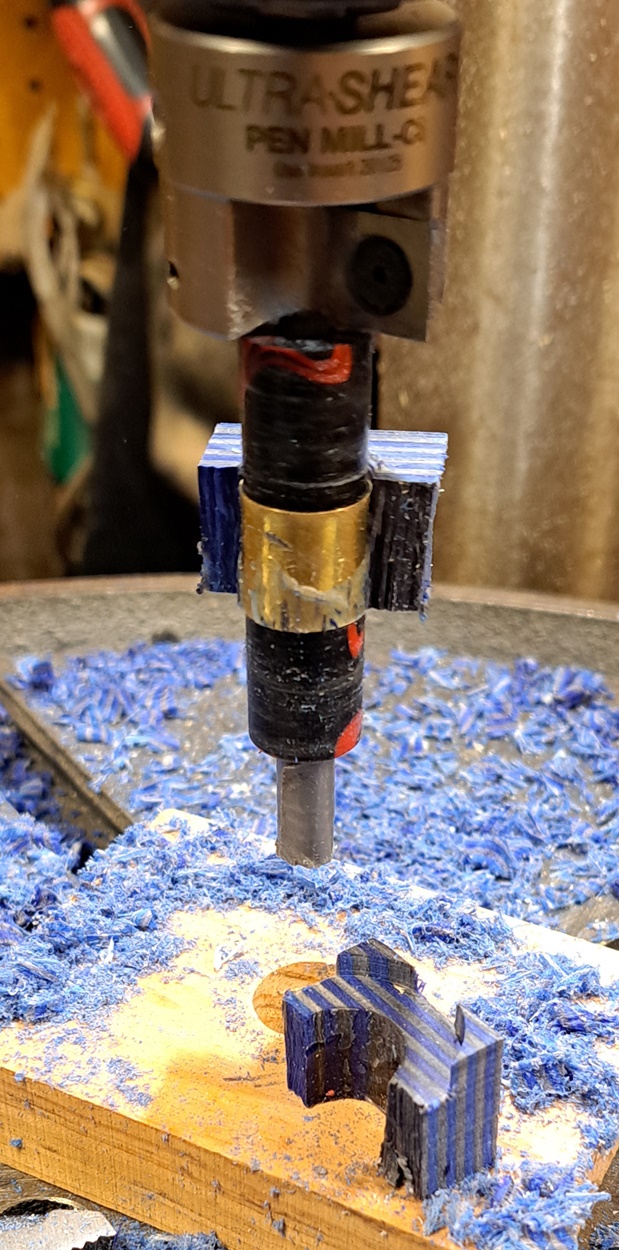

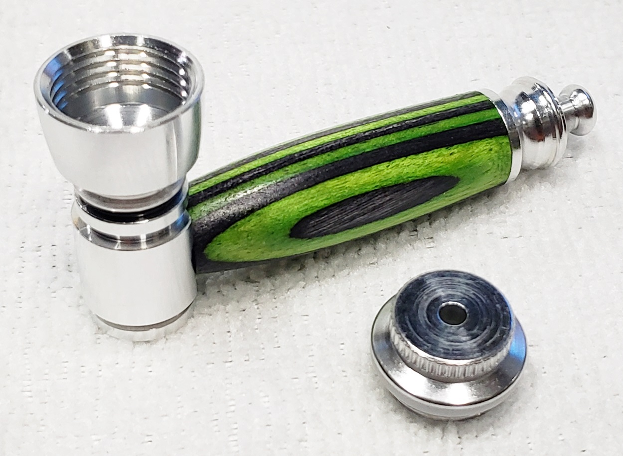

I was originally going to use SpectraPly for both sections, but both pieces broke during trimming. So I gave up and used the Rhino instead.

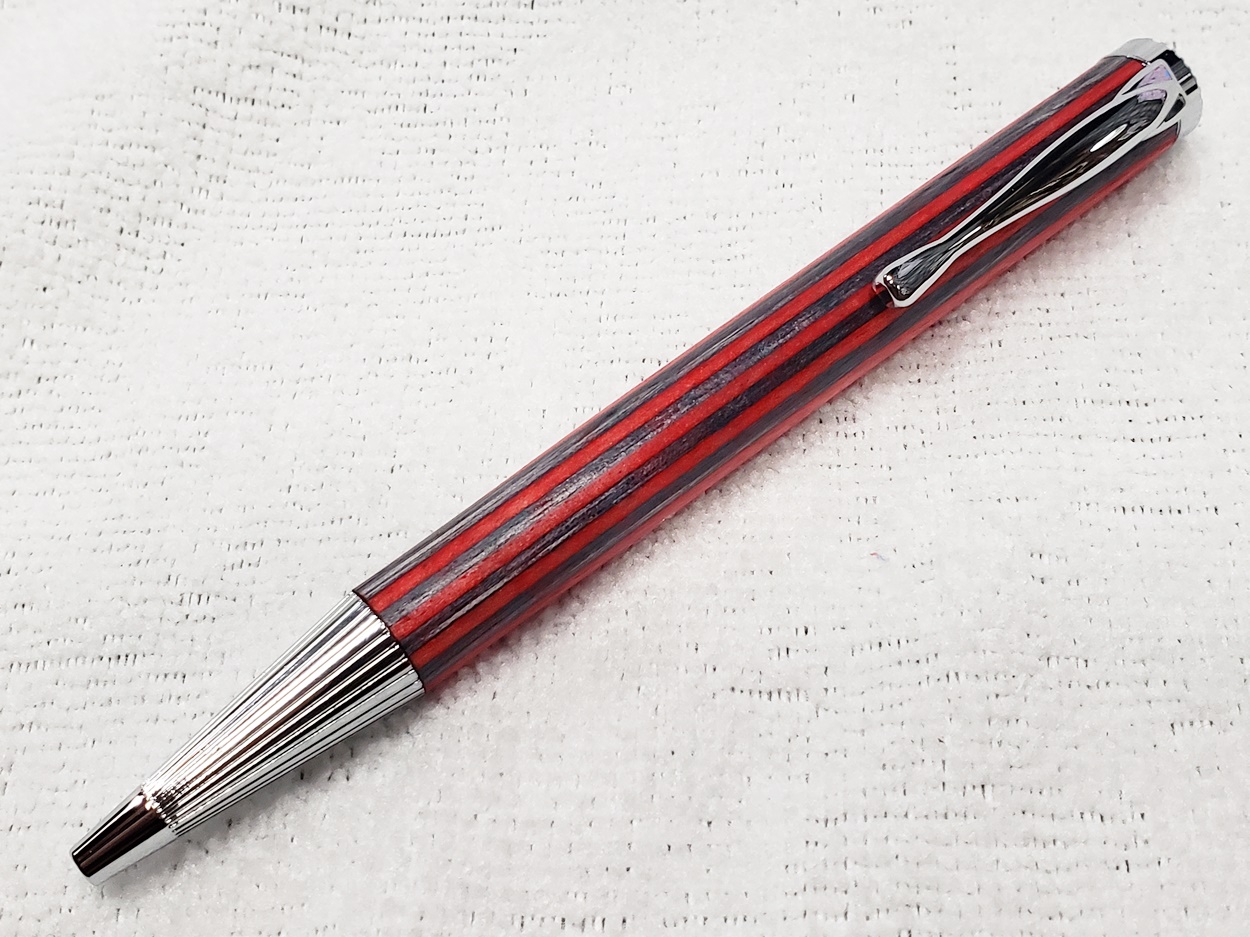

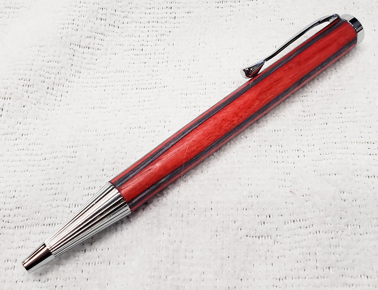

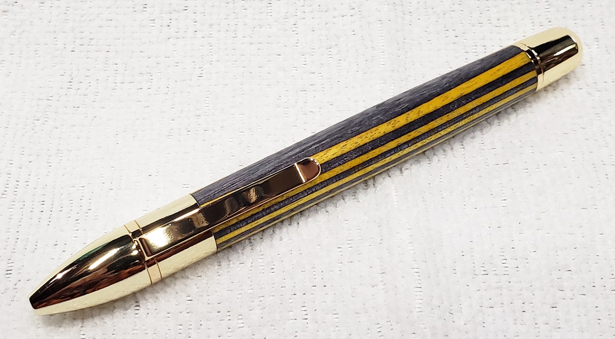

I actually like all SpectraPly.
