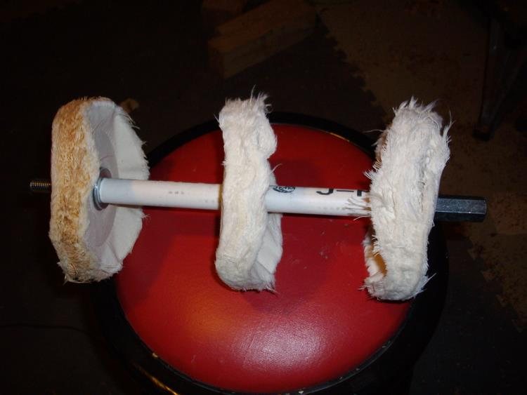

I did my own a week or so ago. This is not original with me. I made it from what I learned on this site, with a few changes to fit my situation.

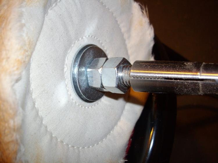

I have ~$30 in it. 3 buffing wheels (6-inch, not 8-inch) a piece of 1/2-inch ready rod (I rolled a couple of them on the floor of the Home Depot before I picked the one I took home), a bunch of flat washers, some 3/4-inch plastic pipe and some 1/2-inch nuts, including a couple of the ready-rod coupling nuts.

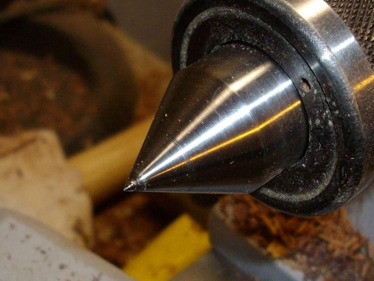

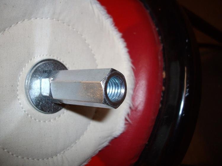

I screwed the coupling nut on one end of the ready-rod and locked it in place with a standard nut. The live center is large enough to run in the chamfer in the coupling nut.

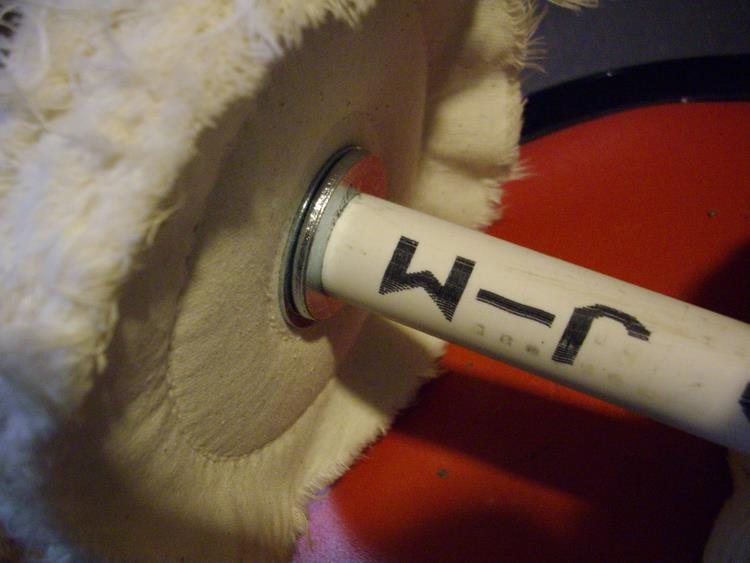

I cut some pieces of plastic pipe and squared them on the metal lathe and put them between the wheels with some large washers.

You can see the larger ring on the live center which is where it drives on the coupling nut.

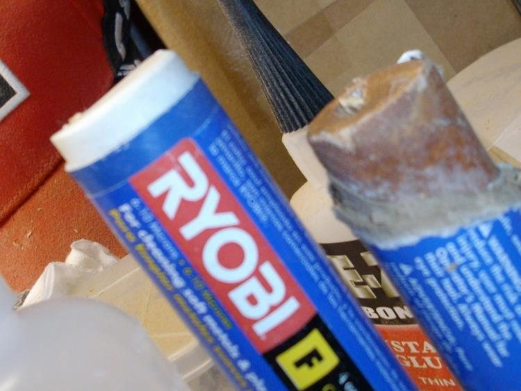

I just bought some tripoli (the brown stuff) and some plastic polish (the white stuff) and use wax on the third wheel.
One thing I would do differently is for the tripoli wheel I would get the sewn wheel - not the completely loose one as shown here. But, hey, when I want to badly enough, I can change it.
It really takes those last few sanding/polishing lines out of plastic pens and CA finishes. I don't use the tripoli on those, just the plastic polish and the wax. it doesn't take much time and pressure and it shines things right up!
I run it on the middle belt pulley on the Delta midi lathe. It runs pretty true.
The hardest part was getting the length right on the spacers and the ready rod so it fit the lathe. I just used trial and error until it fit. The spacers ended up ~5.5 inches long and rod is around 14 inches or so.
