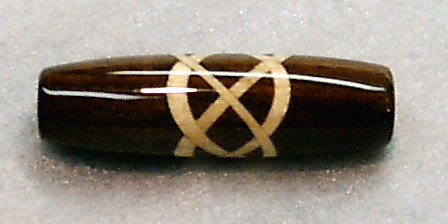

Are you trying to get a CA finish like the pieces pictured below? I don't use paper towels. I don't use BLO. I don't use thin CA. No hocus pocus.
I do use accelerator. I do sand. I do use thick CA. Just straight forward CA application. In fact, my SIL just turned his first pen today. I talked him through the finish and it is just like the pics below.

You can see one a my CA finishes here on this one Dalmatian ebony on top and black ebony on the bottom . IMO the bottom looks like plastic but it is wood this pen just sold for $150.00 [:D]
