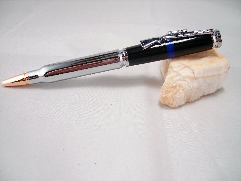

The "Thin Blue Line" pens have been getting a lot of interest lately. I'm really glad to see that. Not because of my traffic, but because the police seem to be needing all the interest and support they can get right now.
Here is my Thin Blue Line pen...
ry%3D480
I like the concept but there are a lot of scratches in the black part. Try to re sand at 400 and 600 them MM to 12,000....it will look soooo much better :)

I told you they were hot right now. Just sold the second one in two days. Now I gotta order more supplies.....
Yes, that is what I use too :) But I can see the scratches in the photo you posted...just trying to give you some advice...sorry didn't mean to offend
It's all good. Are you talking about the lines just about even with the tip of the rifle? I think the next one I do, I'll go up to 1200 with sandpaper, then switch to the micro sanding. Maybe I'm skipping too many grits starting with the micro pads.
Probably incidental reflections or other light sources nearby .... possibly some dust or fingerprint smudging on the pen before photo was taken?
I'm seeing extra light reflected from random spots on the pen too. My first reaction was to think- Oh ... a few scratches ... he should have polished that up a bit better.

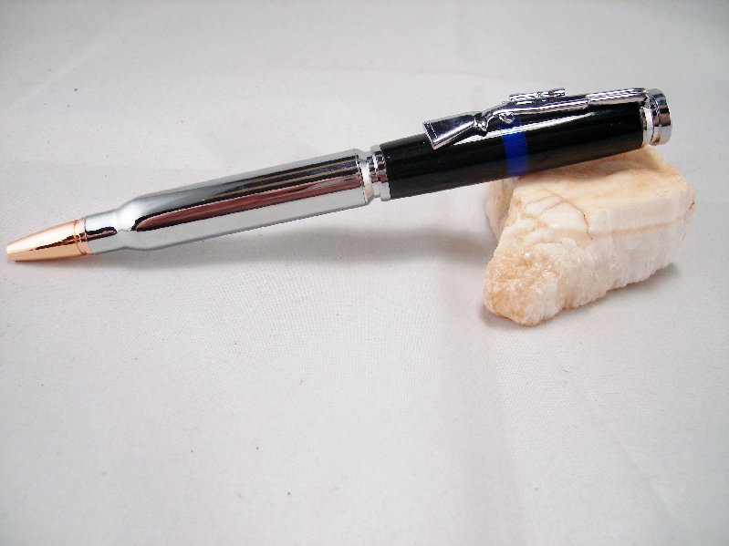

I blew it up for better detail .... and added some arrows to point out what I can see.
The arrows each point to some reflected/refracted light that appear to be scratches. Some are in line with the pen, some are at an angle or are just small points ....
The area that is circled is showing definite signs of radial lines. Polishing with PlastX can reduce marks like this substantially, but sanding laterally in between grits is the best and most effective means of getting rid of them.

I think a lot of what is seen in the photo is multiple light sources. I take these pictures under a chandelier light that has 10 bulbs. Plus, I open the curtains next to the table I take these on, so there is natural light as well. I'm not a professional photographer and never well be, so this is what I have. I agree that I can see some radial marks. I'll make sure that doesn't exist on future pens. Also, keep in mind that the blank I used isn't just plain black. It has some pearl effect mixed in as well, so some of that can be attributed to below the surface. I'm sure there are some finger prints on there as well. This was one of the first "Thin Blue Line" pens I made, and at that time I wasn't even selling on Etsy. I know the policeman I gave this pen to didn't notice a thing and was totally amazed by it.
In holding this particular pen, unless my eyes are getting worse than I thought, (getting older sucks by the way), only people like us that make pens would ever notice these issues. Or, someone that takes a close up photo with a multi-megapixel camera and blows it up. I do appreciate the critique though. I'll start taking pictures of the blanks while they are still on the lathe and zoom in to see what I can't see. That will let me finish off anything that shows up. I might try the wax idea too.
