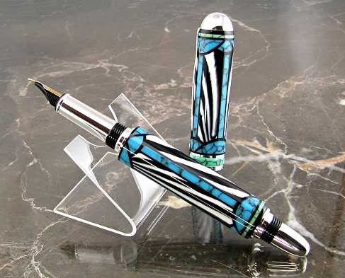

Some of you may remember this little number ...
... from a while back.

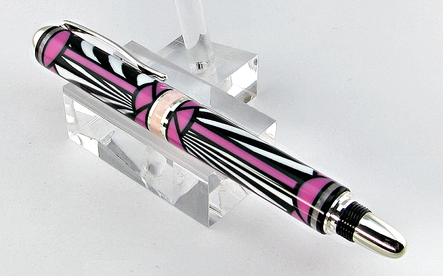

Here's the same idea with ... pink. Lots of Pink. Very pink pink with some light pink. It's an order for a friend, who is giving it to her sister. Being a manly man, it's not something I would have done on my own, but I like how it turned out.

How did you keep the resin from mixing when your poured these?..........Very nice. I am really amazed by them. I cant even see the kit, I cant take my eyes off the blanks.
Both of those pens are beautiful. Brian, The top one is Kasper's too. It was in the random pictures about a week ago. It caught my eye then, maybe that's where you saw it. Of course I'm not exactly sure how the random pics works...whether or not the random pic are the same for me as they are for you.

I tallied it up this time, and it takes 20 hours to make this. Except for the scallop pieces, each piece gets "dimensioned" in a thickness sander. The glue ups are tricky, and the blank scallop cuts are trickiest of all. Really, all that dimensioning ought to be done on a milling machine with a good angle vise. Maybe one day.

Do you use the Byrnes tools to make these?
Yes. The saw and the thickness sander. There are some interesting things you can do with the precision disk sander too, but I haven't got around to those yet. Never enough time.
FWIW, if you have those machines, I find it's important to clean off and wax that saw table frequently. On the thickness sander, I use those little cans of compressed air to blow the dust out of the sandpaper drum after each pass. All the plastics are troublesome, but Lucite is especially bad. Cutting and sanding it creates a lot of hard, messy, clingy, pellet-like dust that will clog up the works quickly. Just enough to throw you off, especially on those 45 degree angle cuts.

Was wondering....what kind of time(hours/days) do you have in one of these?
I said 20 hours earlier in the thread, but there a few things I forgot to take into account so really, it was closer to 25 hours. But I learned a couple of new tricks so such time is never wasted. What was it GK Chesterton said? "An adventure is only an inconvenience rightly considered."

If I remember right there's 72. Let's see: the zebra blank is halved, and each half is quartered (8), 16 scallop pieces with 16 veneer pieces (32), eight straight line pieces with 2 veneers per (24), a veneer piece at each end of each pen section (4), an accent piece at each end of the pen (2), a thick veneer piece to match the thick black band on the Sedona cap finial (1), and a centerband piece (1): total = 72 It would be interesting to figure out how much, of all the blanks used, is left once the pen is turned down. I suppose one could calculate it by weight. My guess would be 2 or 3%, but I wouldn't be surprised to find it's less than 1%

Thanks! I'm not a fan of pink either. I would never have done this, were it not a commission. However, I do think it works pretty well. I just wish we could have found a pink that was slightly more hot pink, and had some veining or pearlesence or some other "interest." Maybe PR PRincess could make a hot-but not too hot- pink.
