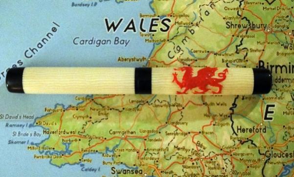

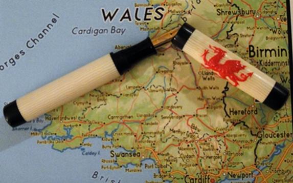

Casein from you know who embellished with a little PR and ebonite.

Me likey!!!!:biggrin: But tell us more please Bruce. How'd ya do it?:confused:
Puff the Milky Dragon...:biggrin:
I'll guess that the casein was turned and then lasered. Then re-cast in
red PR and turned again. If I'm right, do I get a star? :tongue:

Close but no star. Casein was turned, red PR cast around, turned again, then CNC all the red away except for the dragon. Took 4 tries and considerable set up time. Requires near 0 run out.
Ah.. so the dragon stands proud of the casein?
You're a brave man. I'd have parts flying about the shop..
oh wait.. I already do

Charlie,
I believe this method would result in flying PR. The bond to the casein is unlikely to be strong enough to stay attached as PR is removed.
The method is, however, interesting. Try it with PR and PR, rather than casein.

PR stuck to my casein real well.

You could certainly be right, but you know us stubborn Irish . I HAVE to
try it now.. :wink:

I was privileged in that Bruce shared with me some of the WIP on this one. The photos that were posted really don't give the true 3D sense of the Red Dragon. Heck I don't think this one does either. But each flap in the wing is curved and rounded in full relief, as are the armored scales on the body. From the itty bitty claws down to the loop in the tail, this is a full 3d carve.
I can only guess at the amount of hours and skill that went into this. It is truly an amazing thing!! Kudos' Bruce! :cool: :tongue:
