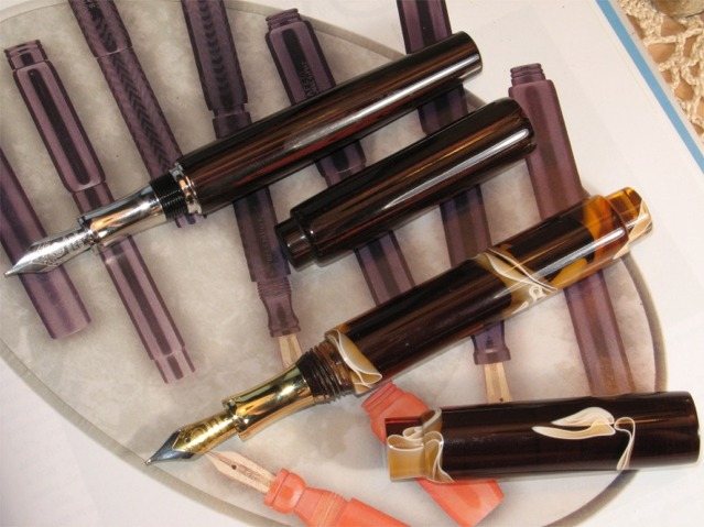

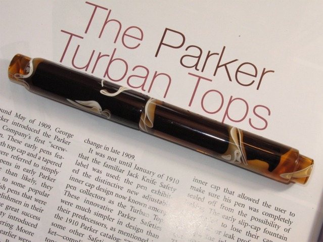

Here are a couple more Turban Top pens I made simular to the 1914 Parker's catalog pen the Jack Knife Safety. One is lucite and the other cumberland ebonite. Both are very BIG PENS.
You know what they say...Big feet, Big hands.....Big pen s :D
Thanks for looking

Mike, it is one of the new lucite rods from www.pipemakers.org I checked on the web site and couldn't find it. I think it is carmel but not sure. Very transparent.

Can I ask where you got the tap for the threads in the cap?
The lucite one was threaded, the ebonite one has the coupler from a gentlemens pen.
I buy my taps & dies from http://www1.mscdirect.com/cgi/nnsrhm
They have really good service and have anything you want.(almost) [:)]

Shane, I don't know to much about threading (yet), but most of the threads on the Jr/Baron, El Grande/ Ligero and others are EE & EEE, which means it has several starting points. I don not believe we can hand cut threads for that. But that would be a question for Bruce or any other tool & die makers lurking around here. The only regular type threads on the pens we buy are found only in the nib section and in the trim end caps.
The ideal kit for me right now, if I could just buy couplers and a nib, then I can do the rest. I really don't like threading myself. I don't have it down or have the right tools, I tend to scrap 30% of my threads. I am working on a friction fit cap.

Anthony, I'd also like to see us come up with a few viable alternatives for the threaded sections. Doing multiple start threads is definitely a trick by hand, but can be done on a small metal cutting lathe. It would be nice to have a few different types of designs that hold the cap on that people without CNC or molding machines could easily do. That kind of stuff should easily get you into the Guild. It takes thinking outside the box a little. Some of the best cap fits I've felt involve a trilobe plastic shape that gets deformed to round when the cap is pressed over the round pen body. Those again aren't necessarily easy to make though.
