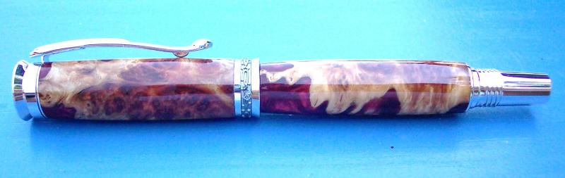

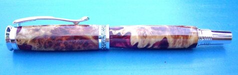

Another of Eugene's mutts. This time it a red one placed(sure he has a name for it, but I don't remember) on a KJP Jr. Marshall Rohdium and Blk Ti..This is a super nice kit. Very stylish and sophisticated. Embelishments on the cap and other end. If I could take a picture worth a crap I would show them to you!

Rollerbob, that is a very nice looking pen. I think you beat me to the red ones and so I ended up buying the purple ones. I have yet to turn mine but wondered if you could tell me what type of finish you used on yours?
Yep, be glad to. Sanded 320 thru 600, then 6 coats blo/ca and mm to 12000 and finished with Hutt Ultra Gloss Polish. A lot a fun to turn!!
