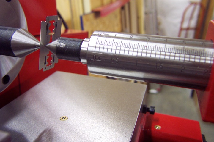

So tell me.. besides eyeballing it, how can you ensure that the centers are lined up? And, what is the acceptable amount of being out of line?

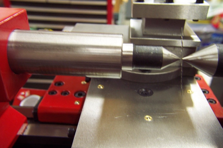

Well, depending on how anal you are, and how precise your equipment is, there's the razor blade test (see the pictures below).
You can read about it in this review of an HF 8x12 metal lathe (about half-way down the page):
http://www.annisquamgranite.com/8x12ReviewPg2.htm
Personally, I just run them up to just touching and see if they match. If not, then I start shimming things until they do. Assuming that your lathe is made correctly, you should be able to get suitable accuracy just by visually checking. As an example, my tailstock is a little bit lower than my headstock, so I've got it shimmed with about four layers of blue tape on the underside of the tailstock where it rides on the bed.
Hope this helps.

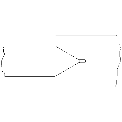

Made some sketches
I made some sketches
Disclaimer: This is my theory that I developed from dealing with out of round issues. It is not ment to claim or disclaim anyone elses thoughts or theorys.
Anyhow here goes. In the good angle skertch you see how a TBC bushing should match the lathe center, and the contact area.

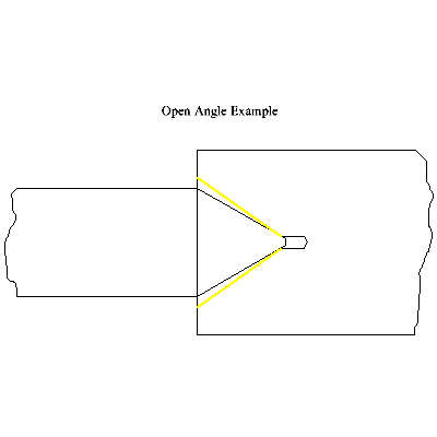

In the open angle you see what the contact area would look like (yellow Lines) if the angle was open.

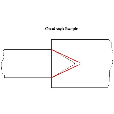

In the closed angle you see what the contact area would look like (red Lines) if the angle was closed.

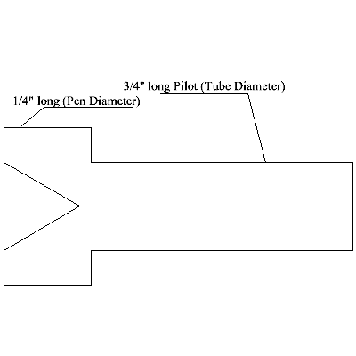

This is the reason I make my bushings as shown below, I make the part that goes in the tube to a closer tollerance then the other bushings, usally about .003" to .005" smaller the the inside diameter. Also I make this part 3/4" long to give the bushing more bearing surface inside of the tube, this gives less chance of the bushing to wobble and cause out of round. (My theory). Also I make the larger diameter (finished Pen Diameter) only 1/4" long to put the lathe center closer to the part I'm turning to help with the out of round issue (again my theory)
A bushing that is only 1/4" long and have maybe .010" or more clearance (smaller then the tube) and a center drill angle not exactly at 60 degrees would be able to wobble enough to cause an out of round condition.
I know that ever since I started making my bushings like above, I have not had any problems with out of round conditions with my pens.
