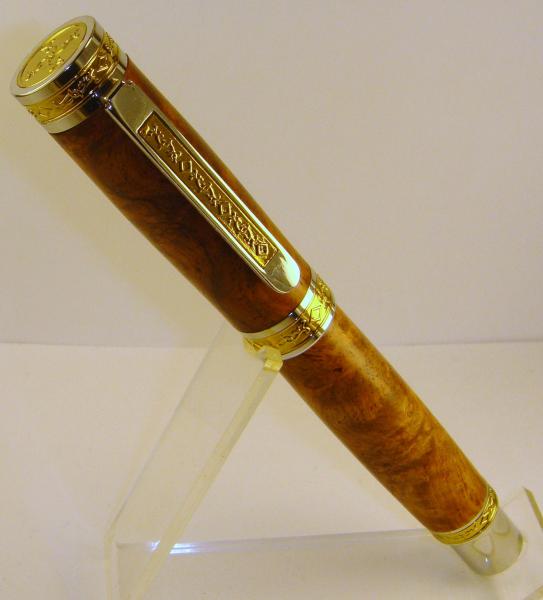

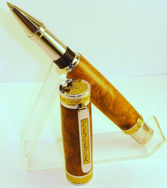

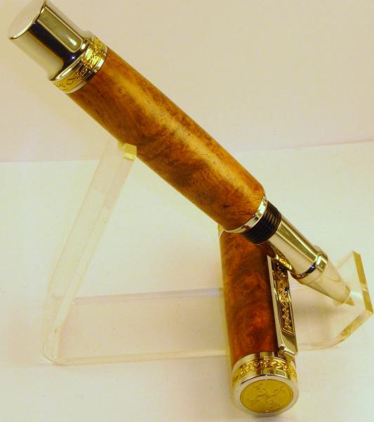

Well I just finished the new kit from Timberbits the Spring Blossem rollerball in Platinum and Gold Titanium. The blank is Amboyna Burl sanden to 12mm than 4 coats CA and wet sanded to 12mm and buffed with a soft cloth. I really like this pen and am going to get some more.This pen is for a person with a large hand.
All comments are always welcome and thanks for looking.

Neat kit and a really nice blank. It apears in the photo that the barrel is slightly oblong near the nib transmition? I think the pen would pop more with a glossier finish but that could just be the pic. Overall well done.
Kind of hard to not like Amboyna Burl, I like the price of the kit, but I have heard a couple of negative comments about inconsistency in the plating, basically the pen is a full sized Emperor at 1/3 the price, I have always liked that pen, and I'm going to order a few I'm sure waiting for some more feedback on them. your work looks beautiful, and the pen LOOKS great. From here !!
