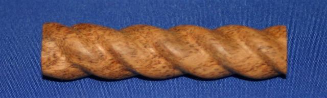

I was dead set on getting a pen wizard until I realized you could not do rope twist with it.
Brian

Thanks for clearing that up Don. :good: I purchased the rope bit and have not had a chance to try it out as of yet.:bananen_smilies051:
For making a true rope twist design the rope twist bit is essential. Other bits I've tried will do twists but they don't look like the rope twist. :wink: The only one I've found has a 1/4 inch shaft and a drimmel will not hold bits with 1/4 inch shafts, as far as I know. I use a foredom handset on a much cheaper rotary tool.
