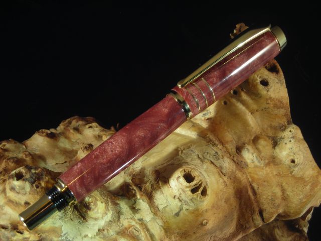

This is The Baroness . Homebrew Pink PR on a Gold Baron with customized center band .
In the photo the pen looks bent , not sure why , It's Not .
See , I do kits occasionally too :biggrin:
As always , comments welcome
Maybe it looks bent because the guy that made it is bent.Hehe just messin with ya.Great looking pen man I like the center band a lot.Fit and finish look great.Your homebrew pink looks nice as well,goes good with the gold.
Man, I have a long way to go. Great work !!!
Since I currently make only "regular" pens, can I ask what is in rings ? Thanks and great work again, Grega
Thanks for the kind words everybody . When I cast this blank , I swirled it a couple of times waiting for it to gel but then got sidetracked and missed the gel stage so the blank looked bland on the outside and I wasn't even going to turn it but it was a really nice pink color and having no pink pens I figured , what the heck turn it anyway . I was very surprised to see the swirl patterns when I turned it .
The CB is the bottom from the original CB and 3 pieces of brass sheet which I segmented into the blank , when sanded and polished it's very close to the gold color of the kit .
