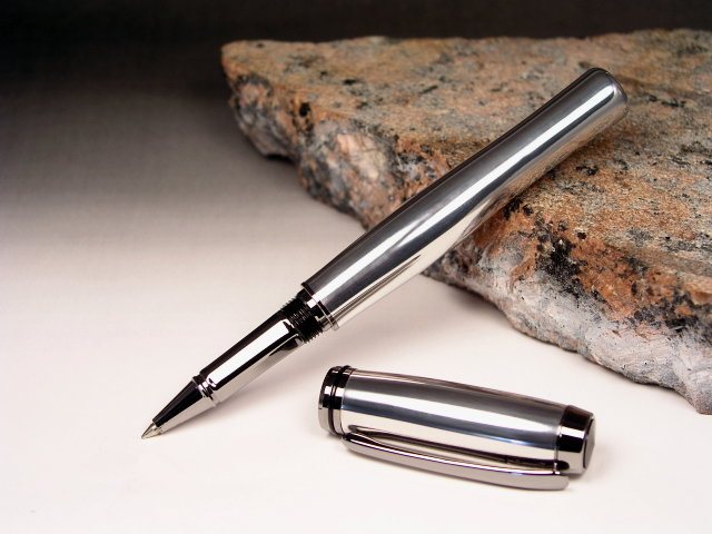

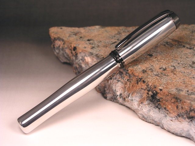

Closed end Black Titanium Baron in aluminum. Head to toe done on jet mini lathe only. It actually has a light brush to the finish, but shows up as a little waxy looking here. This one was very hard to photograph.
Comments always welcome.

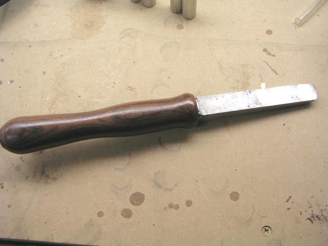

Awesome! I did some steel turning in college, but not by hand. I can't imagine how hard it is to do this, unless you don't actually hold the tool.
Rob
Rob,

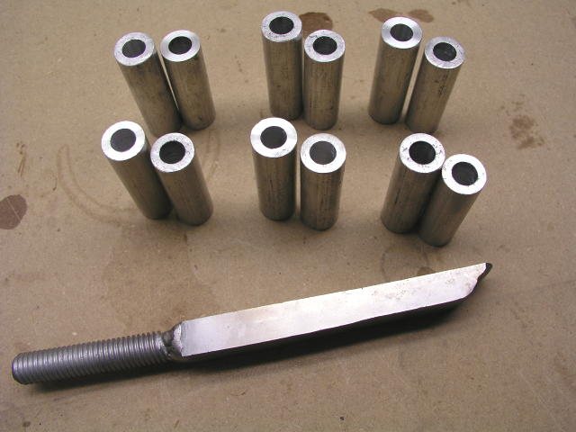

Thanks. Actually not very bad with the heavy tool that I made. Basically a steel scraper from a steel lathe, that I welded a threaded rod to and turned a rosewood hande for.

<br />Beautifully done... but one question... how heavy a pen is it... and how does it balance in the hand..
Thanks Griz,
I was concerned that it would be heavy when I planned it out in my head. It balances quite nicely. Since you cant post the cap on it, it balances well. I weighed it along side of the Bloodwood Closed End Baron that I did a while back. It is only .3 oz heavier:
Bloodwood: Total Weight = <b>1.4 oz</b> (Body = .7 oz) (Cap = .7oz)
Chrome: Total Weight = <b>1.7 oz</b> (Body = 1.0 oz) (Cap = .7 oz)

Interesting.... I would guess if you made it in the traditional style it might even weigh a bit less than the bloodwood...
Have you considered offering drilled blanks for sale... I would guess some of the guys here might be interested...
Also when you drill the blanks.. do you drill them to take the tubes or drill them to just press fit the parts...
That is very impressive. The fact that you made it a closed end pen is what is making me scratch my head. Beautiful pen. I would second the request for pre-drilled blanks if you were interested.
James....That is one good looking pen!! Did you put anything on it to protect the aluminum? How have these traditionally held up to use?
Really nice job. Thanks for sharing it with us. The closed end Baron has become my favorite.

This was the first closed end Baron that I have done in the Aluminum. You are right, it would likely be about the same weight with the fitting on the end.
On these, I usually drill the aluminum to the ID of the brass tubes so that they are not necessary. I like to save my expensive brad point bits for the wood and plastics and I don't have any cobalt or titanium bits in the correct sizes. The Baron top cap is an 11mm ID and a 23/64" for the lower barrel. Normally, the parts press fit nicely into the aluminum. On this one for some reason, two of the fittings neede a small drop of thin CA. They were snug, but not quite tight enough.
I would be willing to make some of the blanks for folks here. What sizes would be prefered? Cigar, Baron? I am telling you though, if you guys have a Supernova or similar with the pin jaws, and a jacobs chuck for your tailstock, drilling these is really a piece of cake. I put a couple layers of shop towel on the lathe bed, and use a little WD-40 or thread cutting oil. Then I face the ends on the lathe at the same time.

On this one I didn't powdercoat. I have had one of the aluminums (Cigar) for about 6 months or so now. Don't use it all the time, but enough to say that it has held up very well. I have powdercoated a few, and they look nice too. Definately a different look however. The PC tends to make them look a little more cloudy. It does not react the same way over brass for some reason. The bare aluminum shows prints, but can be wiped off with a soft cloth. I like the feel of the bare metal too.
Cheers,
Fangar

Originally posted by Ryan
<br />James,
Are you facing the AL with the same barrel trimmers we use on wood?
Ryan
Ryan,
I would not recommend that at all. Actually, I face them on the lathe. Beacuse the stock is already round and being drilled on the lathe, I use a sharp tool to face the end at the same time.
