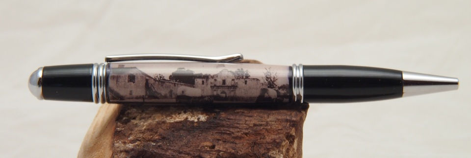

Cwalker935 Member Joined May 18, 2014 Messages 3,528 Location Richmond, Va Aug 10, 2014 #1 Photo circa 1850. Overturned the nib end. I'm transitioning to TBC and need more practice with calipers

SDB777 Member Joined Feb 6, 2010 Messages 6,619 Location Cabot, Arkansas USA Aug 10, 2014 #3 On tube casting, or did you turn some timber down and apply it to that? Scott (need my belly rubbed) B

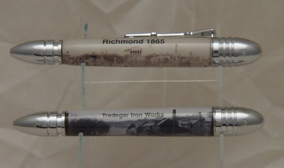

Cwalker935 Member Joined May 18, 2014 Messages 3,528 Location Richmond, Va Aug 10, 2014 #4 Tredeger I have a daughter in Texas. However, i have tredegr covered. Check out the lower pen
Cwalker935 Member Joined May 18, 2014 Messages 3,528 Location Richmond, Va Aug 10, 2014 #5 On tube casting
Bean_Counter Member Joined Feb 27, 2013 Messages 1,069 Location Lubbock, TX Aug 10, 2014 #6 Great looking pen Cody... Pop the components off and build it back up with ca and then polish it up again and you'll never know it was over turned

plano_harry Member Joined Jan 12, 2012 Messages 1,958 Location Plano, TX 75093 Aug 10, 2014 #7 Yep, what Bean said. You have done the hard part. A few minutes with CA and it will meet your expectations!
