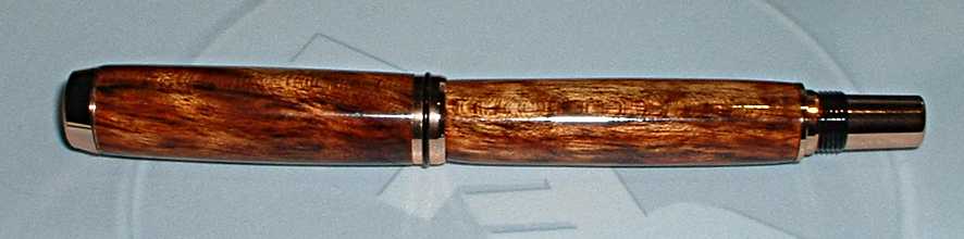

I got some Carribean Rosewood from Harold (Splinter99) and today I had time to try some.
This wood has lots of chatoyance, turns really nicely, polishes up to a high gloss that entices one to consider a natural finish. I didn't.
Here's a Copper Baron Rollerball dressed in the Rosewood and finished with MM, Walnut oil, CA, MM, and buffed out with Plastic Polish
real nice gary. that's a fine looking piece or Caribbean Rosewood. after adding the walnut oil, did you let that dry or go right ahead with the CA?
Andrew,
After applying the oil, I burnish with shavings, then take a dry, clean paper towel or cotton rag and keep wiping while the lathe is running at medium speed. I keep switching to clean sections until the rag or towel remains nearly clean and dry. Then I begin applying CA.
