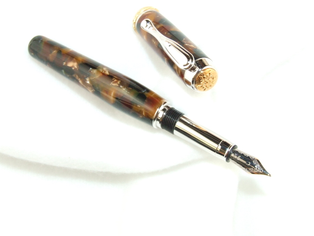

Thanks to Wayne & Driften for some help in setting up a new photo booth. I saw the thread for the 75.00 light booth and Wayne's pic's have been nothing short of outstanding lately, so I did a quicky set up and test before I refine my perminet booth.
Didn't want to spend 75.00 for another photo booth, so went to the hardware store and bought some PVC and fittings about 5.00. Then to Joann's, a craft type store and bought 2 yards of strechy white nylon. You really only need a yard. I have enough left over to make a dozen speedo's :D Did't even bother to buy glue as they fit tight and attached the nylon with....well what else, duct tape ! [:0]
Bought another yard of a white fleece type material for the backdrop. So here it is, tell me what you think. I think it is better then what I have been doing.
