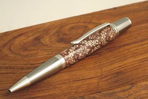

Test blank from Exotics- Dawn and Ed. It is wood with a CA finish.

That is great. Is there any type of seam or does the pattern match all the way around?
Depends on how good your eyes are. :tongue:
The hardest part is getting the pattern not to overlap or to leave a
seam. Some are left with a seam of about 5/1000 which is easily removed
with an Exacto knife. But sometimes the seam only shows up on a small
part of the length and the rest is fine. Doing the math and then fine tuning
the rotary numbers takes care of most of it, but still leaves a lot of blanks
in the scrap bin for tube recovery..
ps .. you ARE looking at a seam in that photo.. so it doesn't kill the visual effect.
