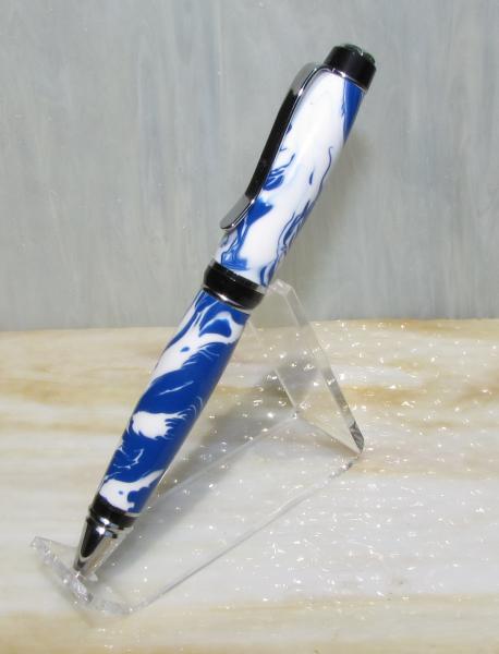

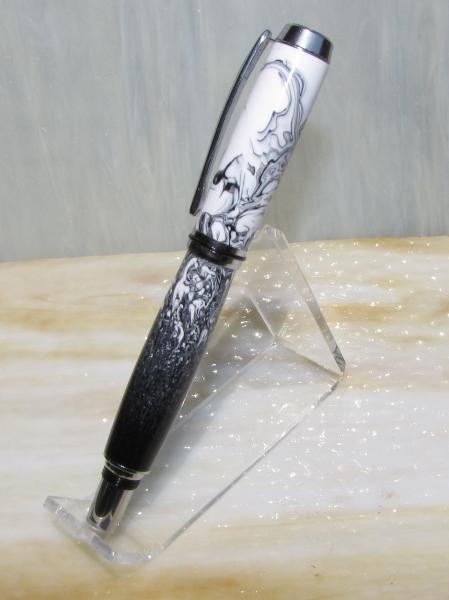

These blanks are from castings that I did this week.
