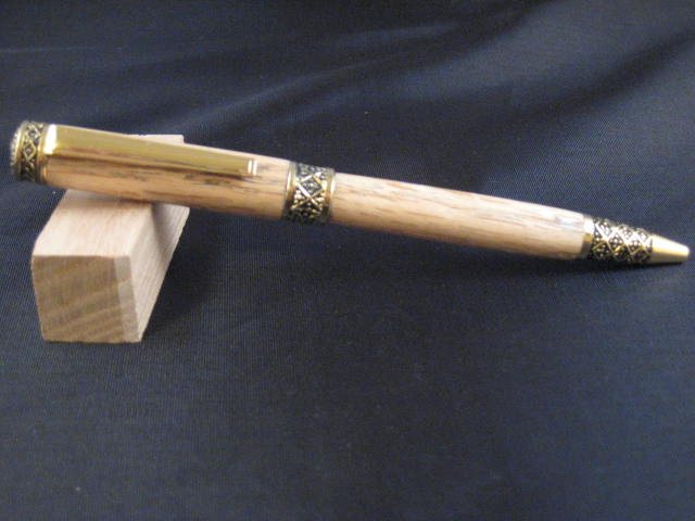

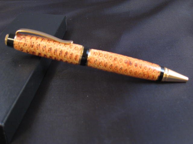

I needed all these things to take better pictures of my pens . I decided to get the kit that had it all together in one box . Did I do good ? Or not ? Any help here ? Thank you !
The lighting looks pretty good and so does the exposure. The only problem is that the pen is slightly out of focus but the black cloth is very much in focus. You're using autofocus and your camera chose to focus on the cloth, probably because the AF area is in the center of the viewfinder. Rotate the pen so that it's basically parallel with the camera back and make sure the pen is in the AF area brackets. Just moving the pen, oriented at it is, to be in the AF brackets will still probably not give you an in-focus pen from end to end.
If you get too close to the subject, you’ll get a fish-eye effect. Back in the old film-camera days, the rule of thumb for portrait shooting was to use a 70-120mm lens (magnification). Same thing applies to digital photography.
Try positioning the camera about three feet away from the piece and then zoom in about 2-3X. Works best with a tri-pod and/or a camera with steady-shot anti-blur capability. This added depth of field will not only fix any fish-eye distortion, but will also help with the focus problem.
The reason for using a longer than normal, 50-55mm lens, for portraits was to make it easier to put the background out of focus. For a 35mm camera, the low end for portrait lenses was right about 85mm and the high end was 135mm. I used a 180mm lens on my Bronica for portraits and a 100mm lens on my Canon.
OK Gerry , you busted me trying to get away with using Auto focus . I'm still getting aquainted with this new camera . I'll have to read up on Manual focusing & zooming . Turning the pen is right on , I just forgot you say to keep the pen paralel to the back of the camera . Let's see if I've learned anything . I'll try again . Thanks for the help guys .

OK , so I still don't know how to focus manually . It was better on auto . I'll keep working on it . It still wants to focus on the fabric . I backed off & used the zoom . You find these kits in the photo developement & camera department . In a yellow box .

I am not an expert by far, however I have been told that using zoom will decrease your depth of field and this is not a good thing when shooting pens because we usually only have 2-3" DOF to work with as it is.
Since you are not familiar with your camera yet, I'm guessing that you have not turned on Macro mode and that's why the camera is focusing on the wrong subject. Look for the flower symbol and turn it on.
Thanks Ron ! That's a good guess , but I am using macro . In fact according to my two little instruction books ( Basic ) & ( Advanced ) I select the little flower , fill the display with the pen , push timer to ten seconds , push the shutter button half way to focus , then push it all the way down . I had to do something else for awhile . I'll get back to the books , I know it's there .Thank you for your input .

Zooming will decrease depth of field. but in reality the only time you need more than about an inch is if you are taking a picture of the pen with it pointed at the camera. controling depth of field with that small of a space gets a bit complicated. I can do it with my 35mm, but have never taken the time to figure it out on my digital.
Mark , if that's the way they take pictures in Scotland , I'm not above trying it here !! Little finger on right hand , does it matter which leg to stand on ? I want to get this right ! How about a hoop on the leg in the air ?
I agree with you Daniel . I had Canon 35mm I could take pics of anything . This digital is another animal , that I think is going to take a little more education to use it . Thanks for your info on this subject . Thanks to all for the help ! [8D]

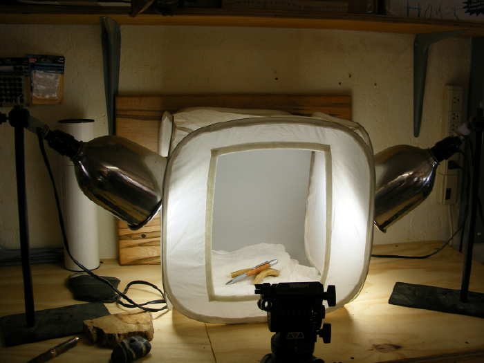

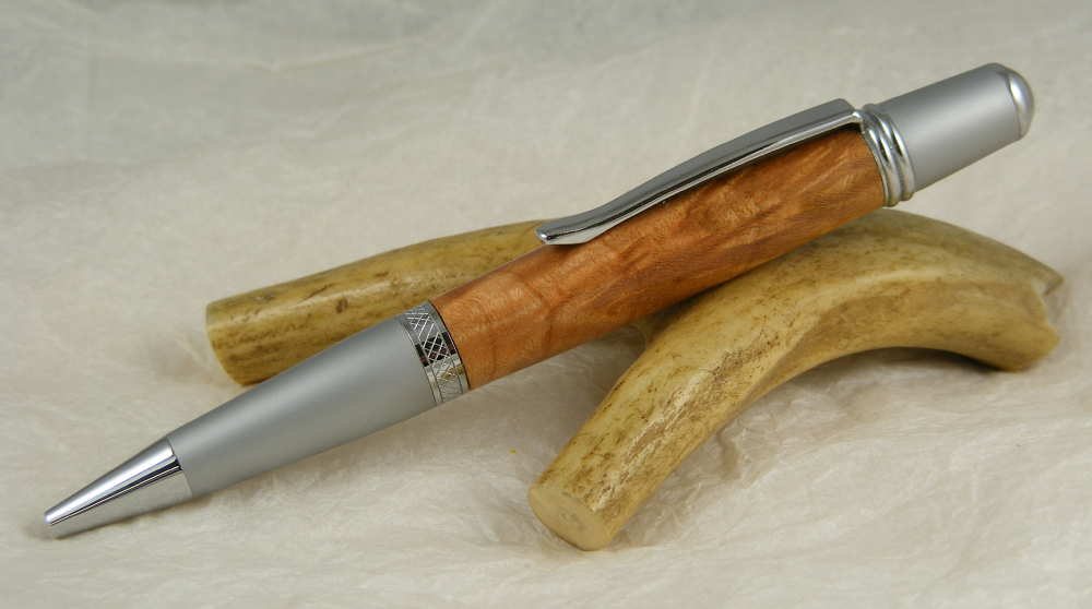

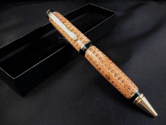

Actually I should have looked at that more closely, mine also has the velcro panels. I saw the lights and tripod were the same and didn't think about the different shape of the tent[:I]. Just checked out their website thoroughly and they don't show ours, just the more expensive version. I do know my WM(both stores) only stocks 1 or 2 at a time so maybe they're just having the misfortune of looking when they're out of stock. They were right by the digital cameras.

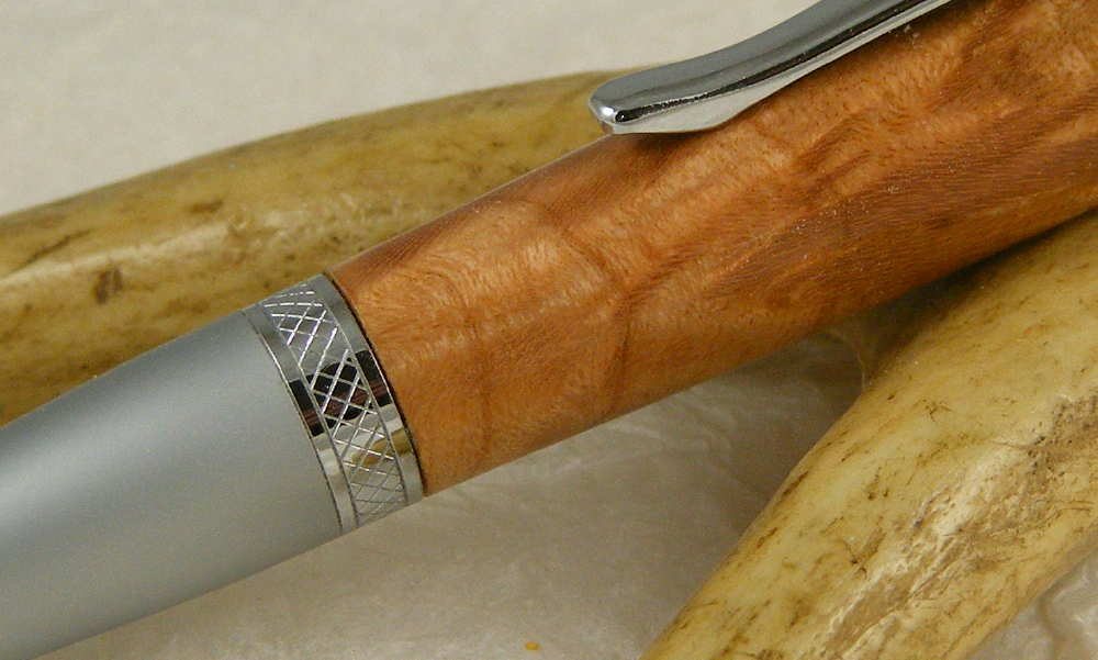

Jim , is that camera mounted on a tripod ?? Yours is the kind of picture I'm looking for with my pens . Shows everything ! Good pictures . How 'bout I send my pens to you ? Thanks for showing this . Here's one I tried today . I'm using a Canon Power Shot A 560 I think Dale looked it up on the net last week . It may not be the camera ! But MY cage rattles sometimes !
Good morning Jim ! Glad I checked on this post . That's a great set up , with good pics of some nice pens . I'm almost convinced , I need a different camera for this close up photography . I like what you have shown here . Thanks for your help . [8D]
