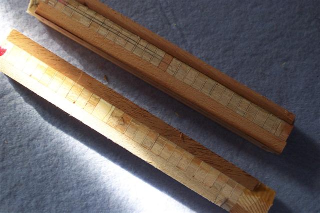

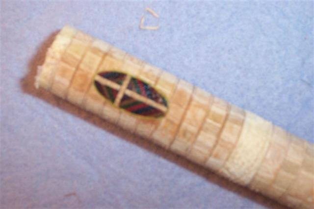

<br />Nice!
I'm still trying to figure out the oval hole ... lol
My best guess is drilling at an angle ... but it's just a guess.

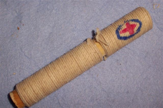

That is exactly the reason.Originally posted by imagine
<br />Binding the layers for additional strength during drilling?
Originally posted by ctEaglesc
<br />That is exactly the reason.Originally posted by imagine

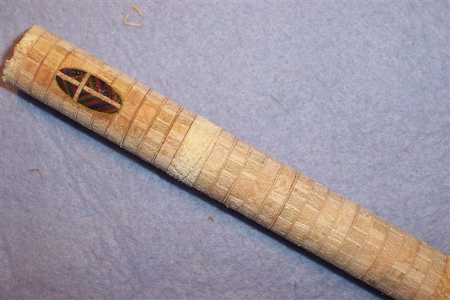

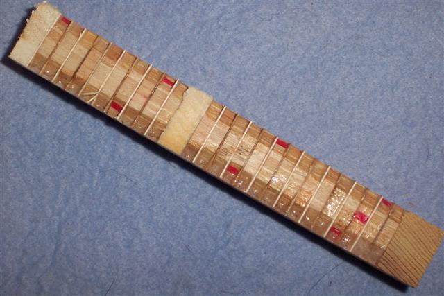

It is not something I do on every glue up.It was something I started doing when I did "flame" a pen made out of plexiglas and and dyed wood. With the amount of glue joints and the differences in materials it is easy to experience a "blow out" when drilling.
This is an added step, but a mishap when drilling a blank like this usually means starting all over from scratch.It is not the case of reaching to the blank bin and getting another blank.It is cheap insurance based on the amount of time I have invested in the pen up to this time.
The string is cotton butchers twine that I wrap with CA on the roughed blank and drizzle CA on top of once it have put two layers on it.
I normally drill using a Beall chuck on the lathe but in this case I will use a scroll chuck to hold the blank for drilling.
