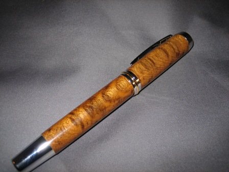

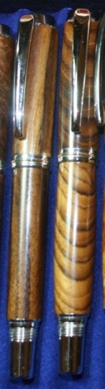

Here are a couple of pictures of Teak Pens. One is "Spalted" Teak and the other two are straight grain and some cut on an angle. Sorry the pictures are not better. I was playing with a new camera when I took them.
I agree that if there is not some significance and or something special about the grain it is pretty bland.
I like the way it turns and all the Teak I have done has been salvaged from Cruise Ships that I worked on so they all have special meaning to me.
I have found it hard to get a good finish and have even tried to have it Stabilized. I think it is so oily that you have to use DNA or Acetone before you finish to have a better chance.
Kevin
