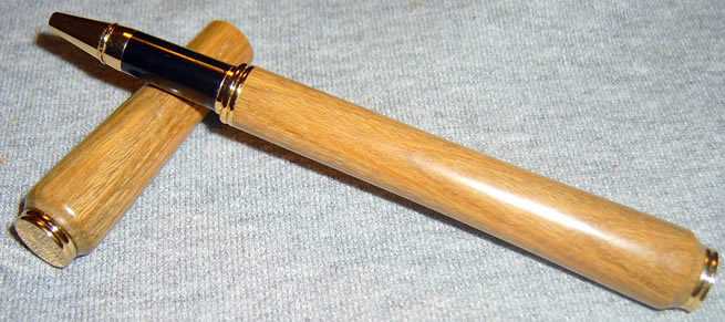

Personally I think Jim had the right idea. Using the woods he mentioned you don't really need to finish them. MM all the way out, apply TSW, Ren Wax, or even good ol' Johnson's Paste Wax and they should shine nicely. They won't shine like lacquer, but they will have a definite sheen and as long as they are waxed properly. I do this frequently with woods like those mentioned.
Here is an example of just this.
<b>Image Insert:</b><br />
<br /> I'll let the "non-finish" speak for itself.
